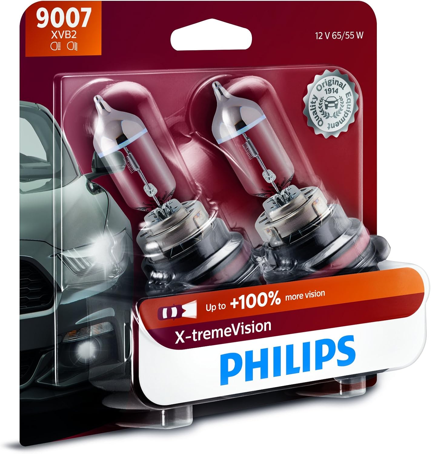

Get new bulbs. Halogen wear and get dimmer over time. There are some phillips bulbs I used in my jetta that were the brightest available. I’ll see if I can figure out which ones and edit.

EDIT: I believe these were what I used on my jetta. Big difference overall. When I got the car used the lights were lethargic at best and forced me to use high beams. The housings were also weathered and dull. After resurfacing and replacing the bulbs they work as expected.
Note: these might not be the correct fit, youll have to look up what you need but odds are they make it in your size.

I dont need new halogens. I replaced them already. It made essentially no difference. Resurfacing would not make much difference. It is best to replace and upgrade. That is my goal.
