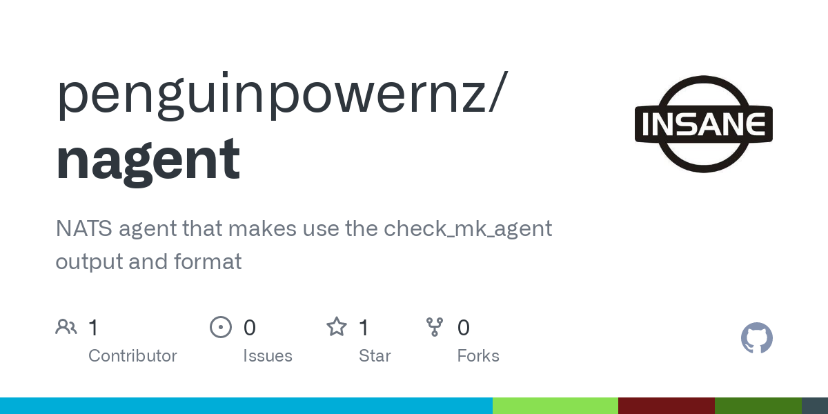

I wanted to expand it to make a micro shadow service that takes the output from check_mk and similar styled scripts and turns it into JSON, and stores it in a shadow for each host that I can pull into other services.
So this thing I made called nagent (NATS agent) sends checkmk style output via NATS, which is picked up by nagentd.
That daemon uses script hooks on the incoming data for generic modification/rejection, but then passes each section within to a script with the same name as the section who converts that data to JSON. That JSON output from each script is then combined to make a shadow for each host.
I cheat a little bit here, leveraging the python JC tool to parse many different outputs right out of the box.
Finally the shadow is then sent to ‘sink’ script hooks which allows you to add scripts to send the full JSON shadow to MQTT or webhooks or where ever. The shadow is also available from an HTTP API.
It’s BYOAuth ATM, but I think it’s good enough for an MVP as the kids call it. I usually wrap all this stuff inside a VPN or SSH tunnel anyway.
I am aware that check_mk have some kind of commercial offering these days, but I have not looked into it at all, so may have just reinvented the wheel (and open sourced it).
Maybe someone can find it useful or have some tips or suggestions for me.
