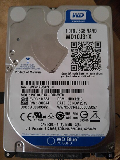

This 1TB SSHD WD HDD is mostly not being detected by 3 computers and 3 external enclosures. Any remedies to try? Or is it time to junk it?
With different enclosures, in Windows 10, the drive shows 100% “activity” in Task Manager but typically 0KB/s read or write except for some blips. It eventually errors out and can’t mount the partitions on the drive.

Has this drive been in continuous use? If so, how long? I see that it was built in 2015 so could be EOL with a hardware fault.
It was used in a laptop for several years until the laptop died somehow. The data was recovered from this drive, and the drive was just sitting on a shelf for a couple of years.
Of course it is EOL, and the product page via the QR code is no longer up. I wonder what the reliability reputation of these hybrid drives is like.

Curious development. After doing a (enhanced) secure erase with hdparm (following the guide here: ATA Secure Erase (SE) and hdparm) the drive seems to function normally.
The HDD is recognized in all enclosures, journalctl no longer shows I/O errors, reading and writing to disk work, SMART shows no alarms with any attributes, and it passed an extended SMART scan.
Has anyone heard of secure erase or similar procedure “fixing” such an issue? Could the earlier errors have been at a logical and not a hardware level, or is this a false sense of security?
