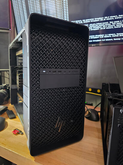

HP Z8 Fury G6i -- Perfect Qwen Flash Next setup (2x RTX Pro 6000s)
You might remember our Z8 Fury G6i from our other videos and setup guides – be sure to check out our full review:
We’re back again and now we’vet got:
Quick how-to on setting up Qwen 3.8 Flash Next on this system but with 1M context! (1.5M aggregate context) and over 200t/s!
Be sure to check out our full review and other content featuring the HP Z8 Fury G6i
Setup Summary
Host: 2x RTX PRO 6000 Blackwell (96 GB), 125 GB RAM, 48 cores Intel Xeon X658X
Model: Qwen/Qwen3.8-Flash-Next-FP8 (125B MoE / 6B active, 51B n-gram table, 4B MTP)
Engine: vLLM vllm/vllm-openai:qwen38-flash-next (0.1.dev20073)
Status: SERVING on port 8000, model qwen3.8-flash-next, 1M context, MTP enabled
