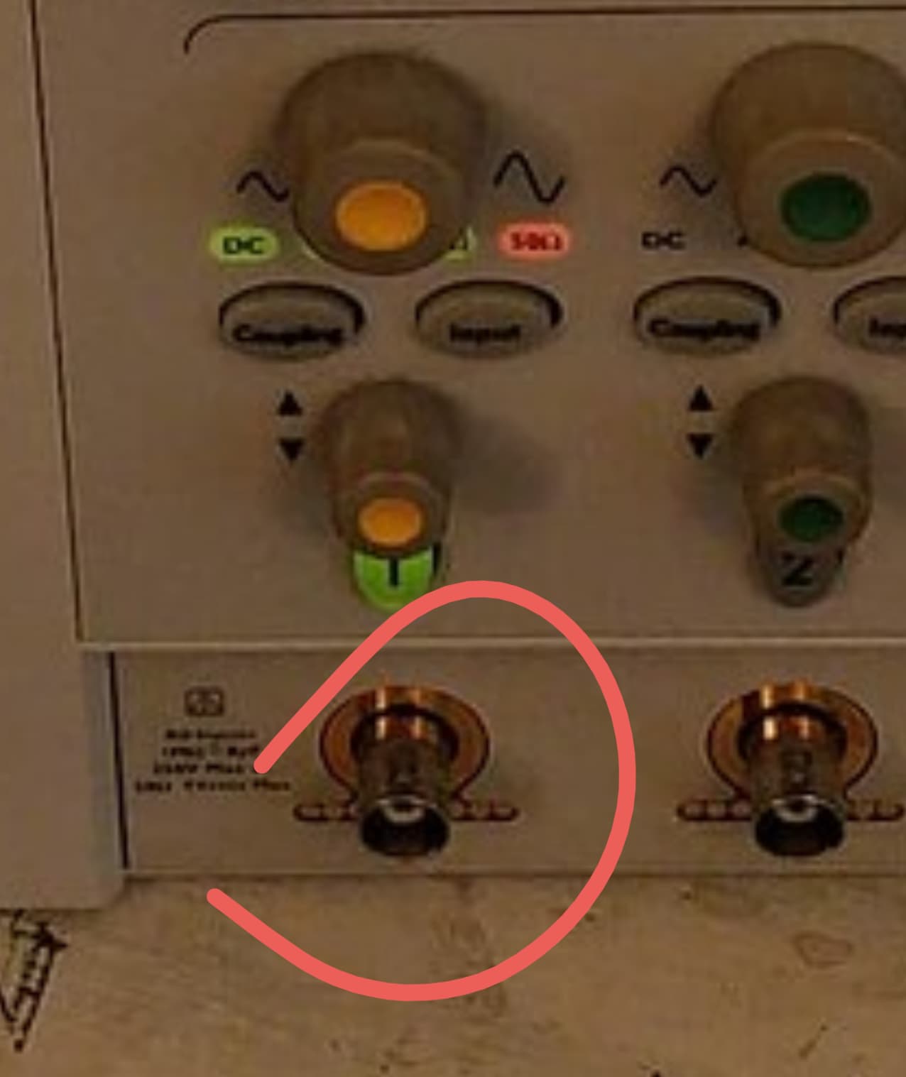

Thanks for getting back to me! I appreciate it. I’m sorry they gave it away on you. That’s not friend-like. It has way more features than I’ll ever need but I know if I got a modern equivalent it wouldn’t be cheap. I see there are different connectors for the probes. Do you know a specific size for them? Thank you, again!
This?
That’s called a BNC connector, now the extra pads below it I have no idea about.
Auto-Sense or power supply for active probes.
