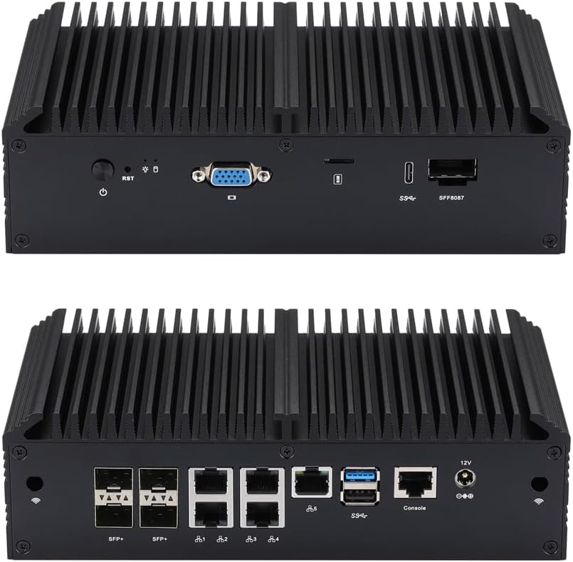

But of course you can get away with some other mini PCs with SFP+ and the like, similar to those reviewed by Serve the Home:

Those mini PCs are mainly what I was looking at before this marketplace find. I think I’ll probably end up with one of them.

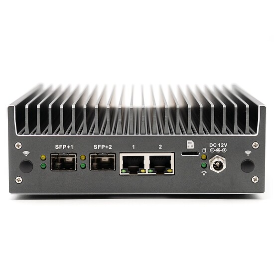

This could also be an option with similar capabilities:
It’s very similar to the mini-pc’s but it’s a US company that does offer support and can use core boot firmware.
