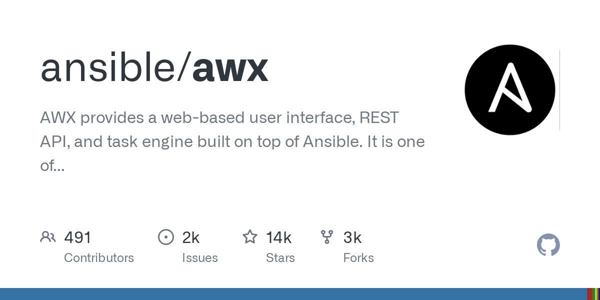

At scale, I’d really like something with a UI. I wonder if there are generic Linux monitoring tools kinda like TrueNAS has TrueCommand.
I could build the UI myself in JavaScript, but I’d need an API to hook into. If I could have all these servers reporting to a centralized server, that server could expose an API. SNMP does this right? But that’s just logging, not machine info.
LogMeIn had a software like this over 10 years ago. Not sure what’s going on there. But you could remotely update and access Windows PCs with it.
Maybe what I’m asking for is just Ansible to program multiple Raspberry Pis at once or a simple cron update task :/.
There you go:
Ansible has it all.

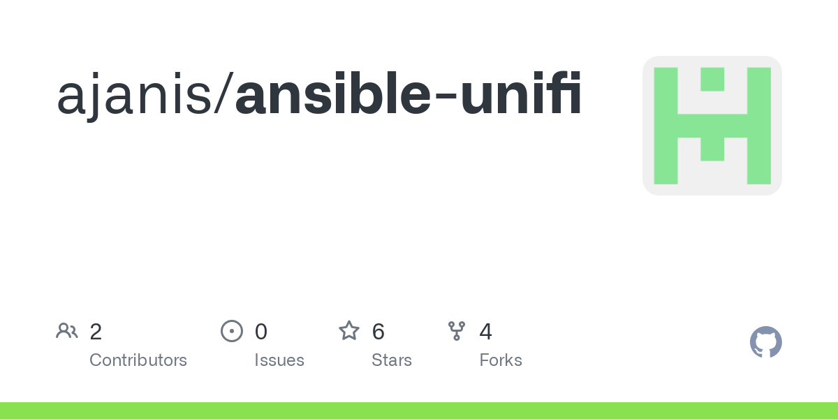

Now I know what I’m thinking of. Systems like UniFi and ESPHome are also in this bucket. Both let you basically have dumb devices that are programmed remotely, but you can monitor them in the UniFi or Home Assistant systems.
It’s very hands-off. I don’t want a full-OS Linux install, I want what is essentially a purpose-built Docker container as the OS.
If Ansible does this, then that’s my ticket!
Then you are looking for different solutions. If you want to host everything yourself, your stack will be quite complex.
I would still recommend using Ansible for configuration management.

First hit on google:
You can force ansible to do a lot of things, but I would start small. If you try to do all of this at once it will be overwhelming.
Start with a Ansible Playbook that updates all your PIs, install AWX and run the playbook from there, Setup your Log / Metric - Monitoring Stack, etc.

Seems like everyone’s pointing at Ansible, but there’s no UI right? It’s all CLI from what I remember.
I found a few solutions (one being an Ansible UI), and I’ll post again if those work for me. I’ve even looked at integrating this into Home Assistant.
