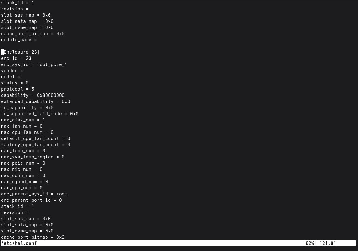

sudo vi /etc/hal.conf

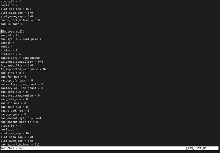

Find [Enclosure_23] and change the value of protocol = 5 to protocol = 9
Save and exit

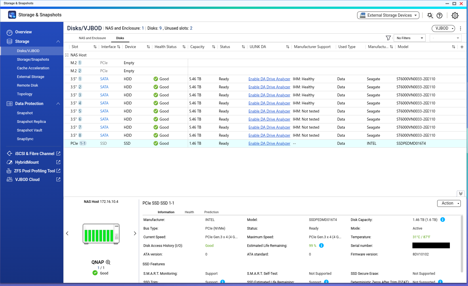

Create a new volume with your freshly enabled flash
