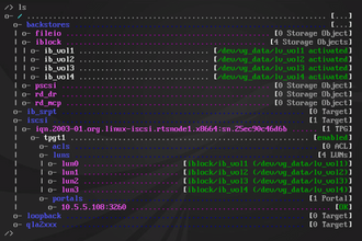

I found (back when I initially created by ZFS system ~2 yrs ago) that LIO + zvols were hurting my performance, but it took a bit of testing to determine it.
I switched over to using fileio with LIO and saw good results.
I havent attempted to test zvols again since, so maybe it has improved.

The LIO that @nx2l is referring to is this:
Politely: Your writing style is difficult to parse.
not sure, I thought we were talking the same LIO…
I was referencing : http://linux-iscsi.org/wiki/Targetcli
(like oO.o said)
…with zvols it was using iblock instead of fileio.
