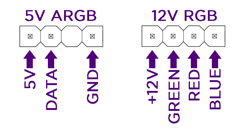

Also the RGB connector is undocumented. The motherboard has a 5V and 12V pin header for that, but it’s stated nowhere in the CPU manual which voltage is appropriate for the header controlling the LEDs.

It’s all either 12V 4-pin RGB (12V, G, R, B) pure analog controls (i.e. your current source on each channel control the brightness, all diodes shine the same colors), or 5V 3-pin ARGB (5V, D, N/C, GND in a typical 4-pin-wide format with 3rd pin missing) like this:
ARGB sometimes has proprietary plugs, but can still be determined by the number of pins present.

Thank you, it helped. Really wish they’d print that kind of stuff in the manual.
