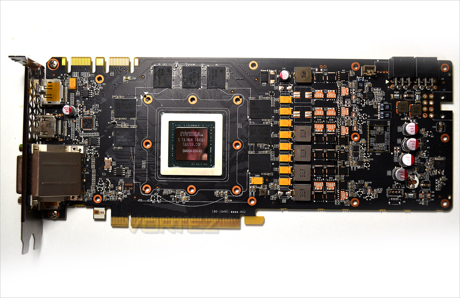

The “AMP! Extreme Core Edition” is the weakest AMP! card. It only has 4+1 (+2 AUX) power phases. So I wouldn’t mess with the TDP limiter.

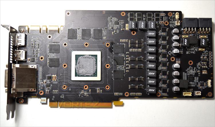

If you wanted to mess with the BIOS, what you should have bought is the “AMP! Extreme” that has 8+3 (+2 AUX) power phases:
So don’t mess with it, you’ll burn it out. The extended software TDP range should be close to the max.
