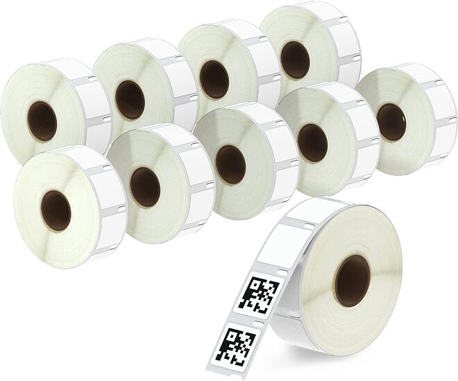

This looks like what I had in mind, but I couldn’t find any Zebra labels that were small enough. I found this 3rd party one but it’s still 1"x1".
That is the type of media I’d like though. A roll with sticker type labels.
I don’t want to cut dozens of tiny labels.
