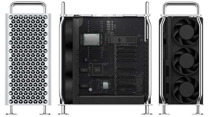

I move around my 750D without issue, even with top fans/radiator, and I move my Mac Pro around too (though that has handles so it’s easier to actually lift) and 2U long-depth servers and a larger not-quite-full-tower system as well. I used to use an Enthoo Evolv TG and that’s not a light or small case either (and the front panel pulls off if you were to try and lift it by that instead of the frame). It does help that I’m large too, but unless I heft ‘em up past my waist I end up shuffling sideways for short distances regardless. If you need to move it far you can set up a folding table as a stopping point.

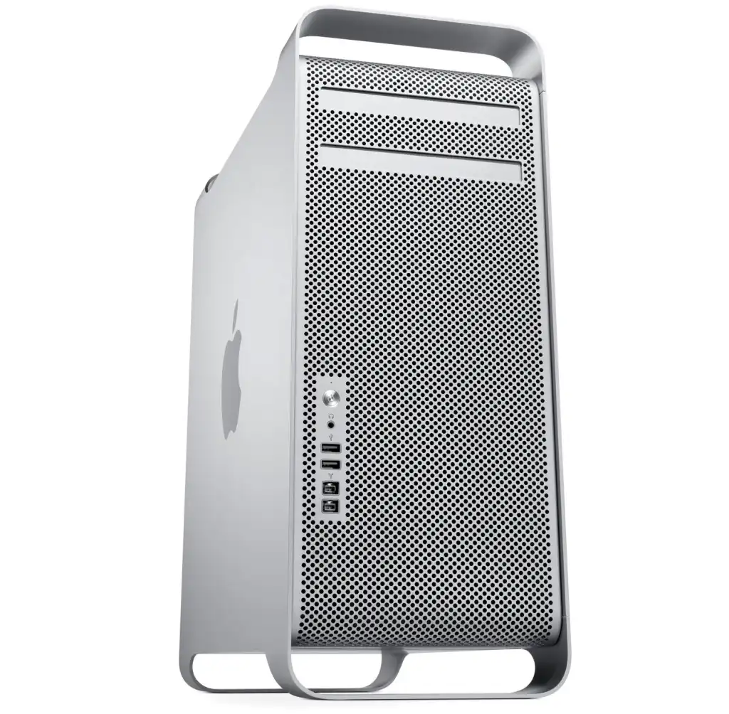

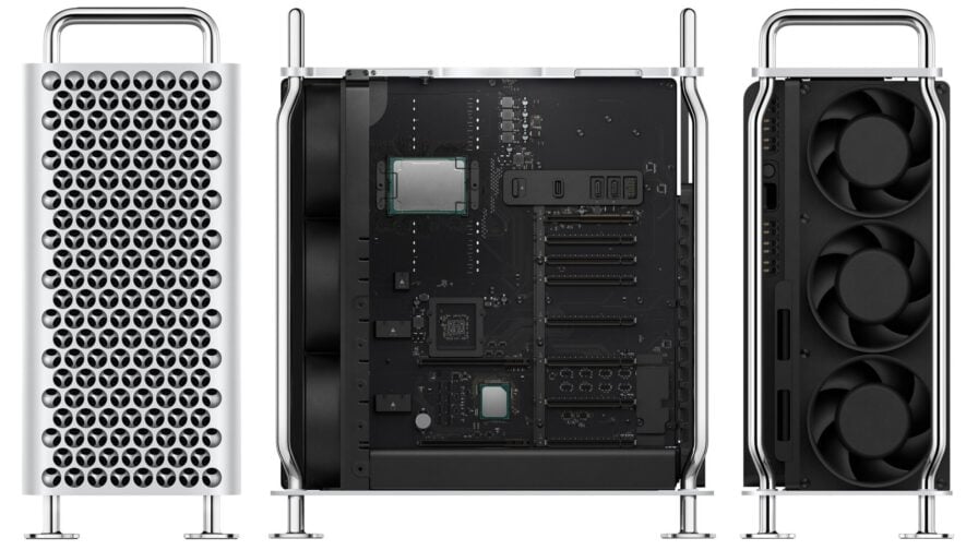

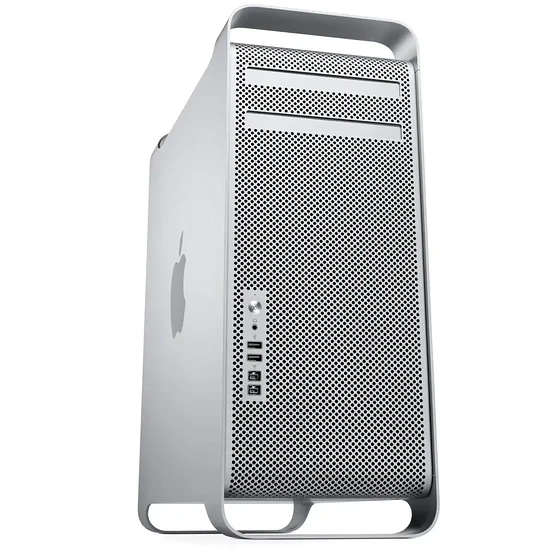

If you put one near the back, and one near the front it’d probably be fine. I always thought that was a big reason why the old school mac cheese grater towers ended up with handles and handle-feet. Those things were tanks even when empty.
Huh, I thought the cheese graters had load bearing structural points there, so one can swap handle/feets, for rack mounting hardware?
Upon further research, not..
The supports seem to go all the way through, but not for racking…
the rack model, was a literal different case
Not sure, I don’t think I ever encountered mac hardware in a rack at that point, just on the desktop.
Multiple cheese graters!?!
