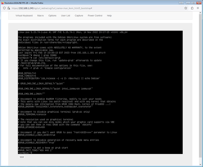

For Intel CPUs, you may also need to enable the IOMMU on the kernel command line for older (pre-5.15) kernels
I did need to set intel_iommu=on despite PVE8 running kernel 6.2

If you follow the instructions for GPU passthrough, it will tell you to add the kernel command line arguments in /etc/default/grub and then run update-grub.
If you DON’T have ZFS root, then this works.
If you DO have ZFS root, then this doesn’t work.
I never did figure out how to get this to work with ZFS root in Proxmox.
I ended up just reformatting the Proxmox OS drive from using ZFS raidz2 to using HW RAID6 (via MegaRAID 12 Gbps SAS 9361-8i) and installed Proxmox “normally”, and everything else worked.
(My test systems were both only using single drives for the OS, and so, I didn’t discover this issue with ZFS root until I was deploying my main Proxmox server where I threw 4x HGST 1TB SATA 3 Gbps HDDs as my OS drive.)
For ZFS root in proxmox you need to edit /etc/kernel/cmdline and add intel_iommu=on
I don’t remember where I found that to give credit but I put it in my notes on how to set up proxmox.
This is what I found independently to work as well.
This is the GRUB command line that I have to edit/put in, to make it work:
GRUB_CMDLINE_LINUX_DEFAULT="quiet intel_iommu=on iommu=pt pcie_acs_override=downstream nofb nomodeset initcall_blacklist=sysfb_init video=vesafbff,efifbff vfio-pci.ids=10de:2531,10de:228e disable_vga=1"

I only have:
GRUB_CMDLINE_LINUX_DEFAULT="quiet intel_iommu=on"
