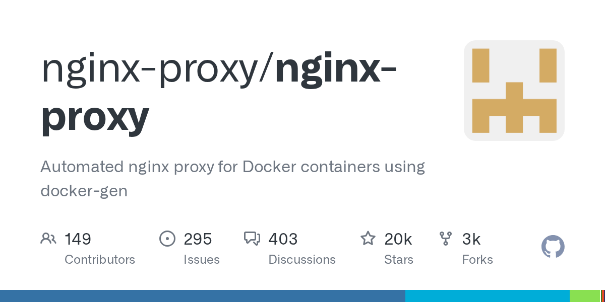

Have you considered using an http proxy, such as nginx-proxy?
The use of such a service allows simple creation of subdomains for any new service (portainer, pihole, etc.) and and accessing the service via CNAME records in BIND.

One alternative to nginx-proxy is Traefik which is Docker-native - haven’t used nginx-proxy personally.
The linked nginx-proxy container provides a nice gui interface and integrates a very easy-to-use LetsEncrypt integration for HTTPS certificates that can be used across the internet or just for purely internal services.
I’m not aware of Traefik having something similar and fiddling with yml files may not fit the OPs comfort level with this tech.
