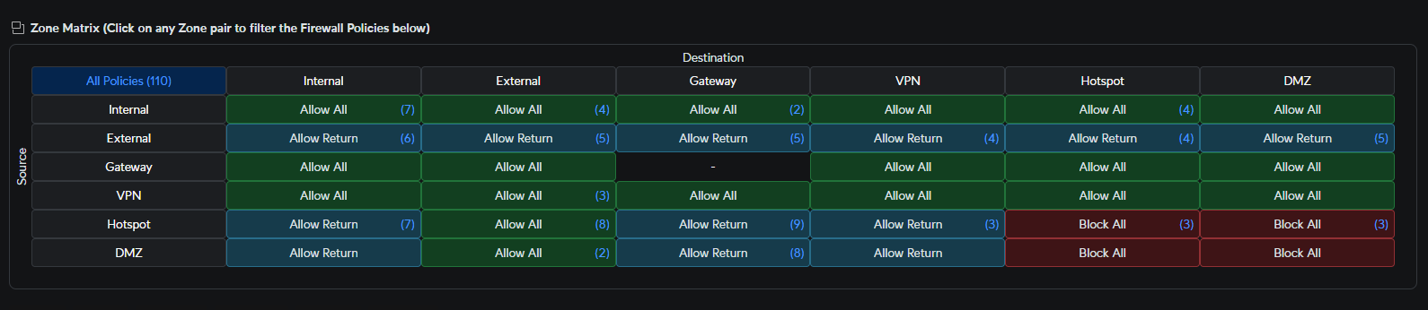

I am have setup DDOS protections on the Teltonika, but my labnet configuration is complicated. The VLAN where the reverse proxy and other services that I intend to push to internet is configured as DMZ.
I have done direct port forwards from my home network, although those are not on the default ports for HTTP/HTTPS but a custom port. This has also worked with double port forwading from my labnet to public. Although that host is not located at the DMZ, since I have not had the time to push that host into the DMZ VLAN.
