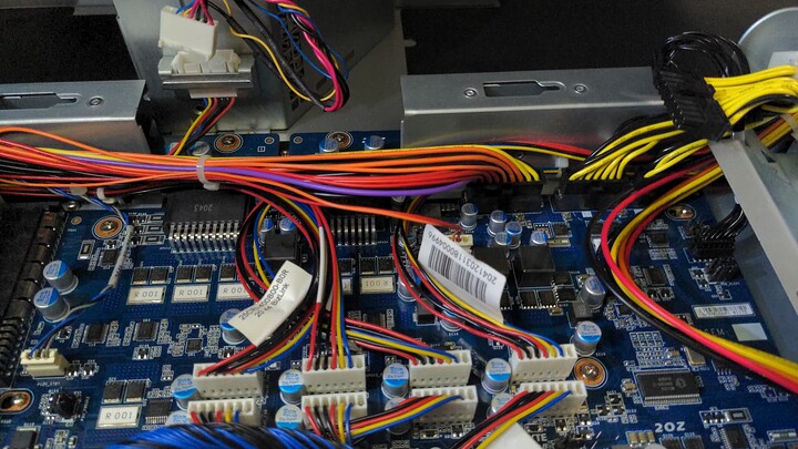

Also, I haven’t found any photos of the underside of this board online, so I will post some. If you know for sure that you want your GPU fans permanently disabled, you can more easily insert the fan simulators on the power distribution board. All 8 fan connections live here.
