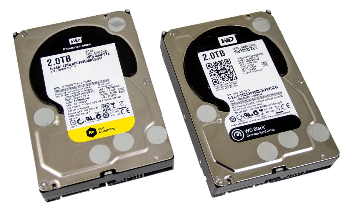

Should be good. Found a nice article talking about them.
Nice article on the hard drives.

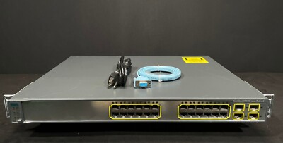

Found this as a possible switch.
If I go this route, I would like to replace my existing 8 port dumb switch.
Will this switch provide gigabit to the devices on my network while also providing POE on the ports that need it? I know some consumer grade switches only have POE capability on some ports.
