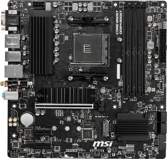

Is importing from Germany acceptable? I would take a look at this:
AM4 is slowly fading away now but is still alive and offers a perfectly viable experience still. Although, I would also get this in the mix if budget allows;
That is enough computer to stay afloat until AM6.
2.5GbE on a $100 board exist but is not ideal. I also recommend consolidating smaller SATA drives to a big one. If you want 2.5 GbE the €130 Aorus B550.Elite AX is a really nice board but way over budget.

No problem with importing, but might be harder to find private people to send things over. But I am in no big rush, so listing good parts to scout for is enough. Like that MSI board has most of what I need (I would opt for non-WIFI version though), so getting it or its 350 counterpart and pairing with 3000 series Ryzen would be a good option (if power consumption is fine).
