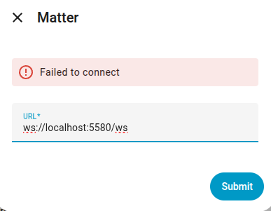

I am having issues getting matter to install on my home assistant instance. My system is running Fedora 43 and is using the docker home asssistant container. My current version of home assistant is: 2025.11.1. It shows up as a device to install and is discovered on my network, but when clicked all it says is failed to connect. Are there any ways i can fix this? Matter would be such a cool thing to have to my home assistant instance! I would appreciate any help anyone can provide!

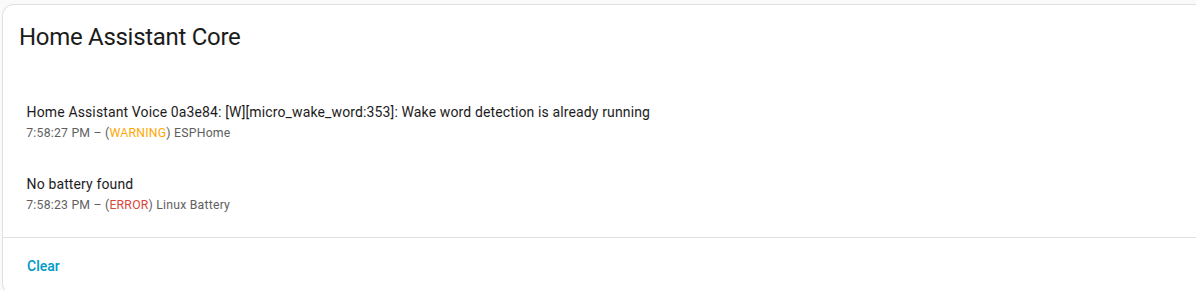

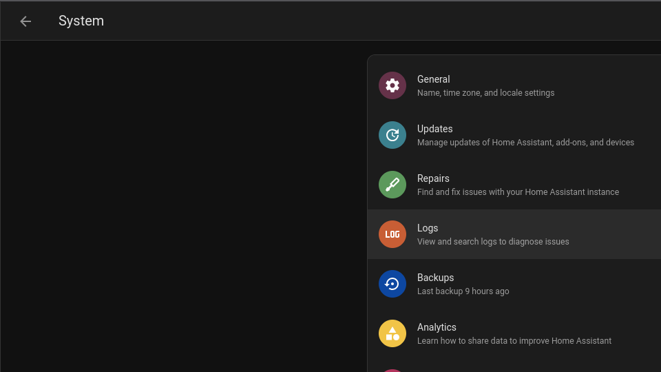

Did you take a look at the home assistant logs to see what it is actually complaining about?
These are the only 2 errors that show up in the logs even after i tried to install it a couple of times again to produce fresh logs.
This is the generic and sparse of information error i get when i attempt to install it.
Matter error

Did you set matter up on it’s own docker image?
I have the server running in a docker container on my PC since i use large llms in my home automations/assistants. So i have to run the matter server as a separate program?
Basically if you aren’t running Home Assistant OS - then that would have worked. Perhaps run Proxmox and then setup a HAOS, but then you can run a windows VM as a primary GPU so you still get the same ‘experience’ you have now but then also get the ability to run LXC containers as well - just a thought, but yes in your case right now it needs it’s own docker container setup.
