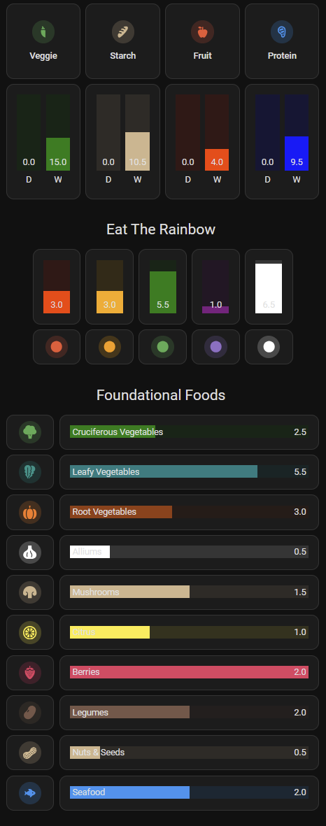

AI Assisted Food Categorization
Using HA Voice and the Ollama integration, I have a local AI server running on my desktop computer that HA uses for the integrated assistant. In addition to general commands like β€œTurn on X light”, I wanted to use the reasoning skills of the AI assistant to help me keep track of my nutrition intake. This was a little more advanced than normal voice commands and fell outside of the built-in intents. So I needed an automation that would trigger on a voice command input, pass the information to the AI assistant, capture and parse the output, and then do an action based on keywords found in that output. Something like saying β€œCategorize a pepperoni pizza” will generate a response that says β€œSure. Categories: Starch, Protein…” ect.
I already had built my wife a dashboard in HA (as a Christmas present lol) that allowed her to record by category what she had eaten that day or week. Each category has an input helper entity that gets incremented as necessary by recognizing key words in the response output. Here’s a section of that dashboard for those who are curious:
It works surprisingly well, but I want to do a lot more with this workflow, and it’s been tricky. I’d like the AI to toggle the entities directly, instead of having to parse the output in a β€œdumb” way. If I expose the food category input_number entities to the assistant, it does recognize correctly what it needs to toggle, but it can’t actually increment the input numbers because there isn’t an β€œintent” for that. When I’ve tried to play with custom intents, I get stuck. It seems HA wants to grab an intent before it gets passed to the AI, whereas I want to determine intents based on the OUTPUT from the AI. More reading I need to do there.

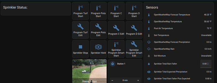

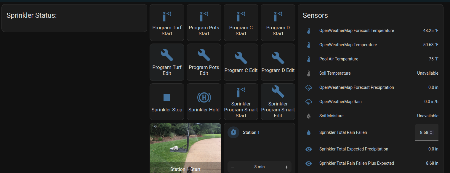

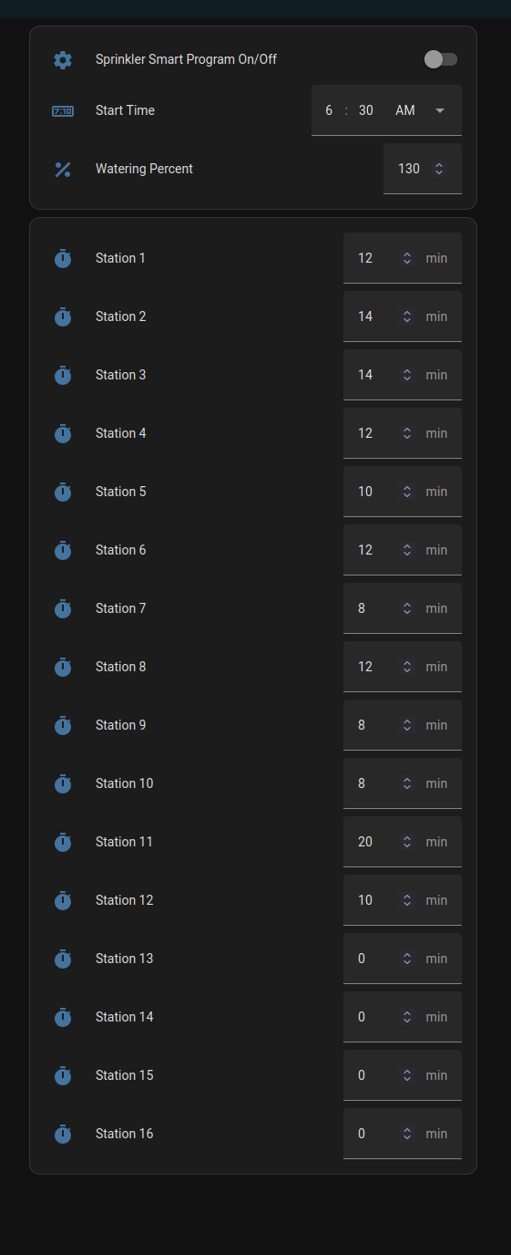

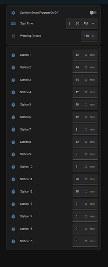

My sprinkler automation is pretty cool, uses local sensor with online weather data to run the sprinkler system using some zigbee relays. Its winter so my moisture sensor is inside with the batteries out, which breaks the status markdown card, but normally the status shows when each program last started, ran, its runtime. Along with tell you what programs and stations/zones are running along with gives an time remaining for everything, along with the running station/zone. I have 5 programs the Smart program is the main one the others are just for manually running any group of sprinklers. As you can see if you click the edit button for any prgram it takes you to a sub page to set the program. Also using the image buttons on the buttons for each sprinkler zones manual start so the so doesn’t have to guess which station/zone is which. To post the automations and jninja2, and helper entity configuration that makeup all of this would be close to ~1200 lines.

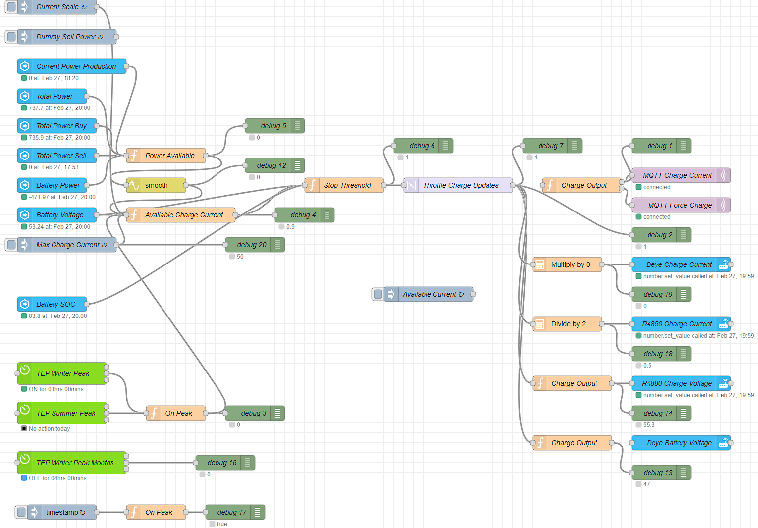

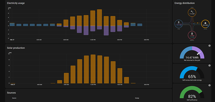

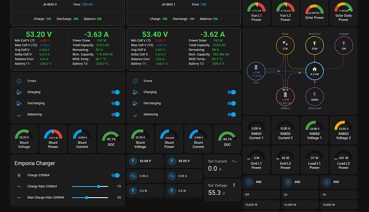

If you’re a Geek and have solar, you really need to hook it up to Home Assistant.

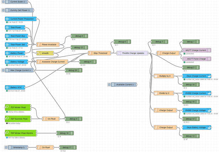

This is my Node Red Home Assistant program that I wrote to maximize solar battery usage. Our power company charges much more to sell us electricity than they pay to buy it from our solar, and we are on a time of use plan, so minimizing usage during the peak periods is a big money saver:
It’s kind of a mess currently, but running 24/7, and working pretty well.

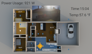

This shows a real-time view of the status of the energy flow:
This is what you get almost for free once you get the sensor feeding into HA. Unfortunately it looks like I removed tracking of total charge and discharge of the battery, so the battery shows 0 currently:
