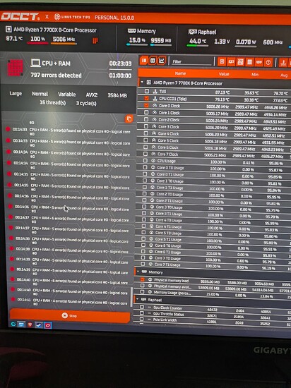

Really sorry for getting back after a long time, in the mean time i reseated memory and the CPU. 7700x has igpu i tried using that the white trails still appear in the OS. This issue started on Arch that’s why I installed cachyOS. The white dots do not appear in the bios/uefi or even when gaming. Thanks for the help still don’t understand what to do. All pc parts are new and in warranty.
Is it another case of ASRock mb killing the cpu? I have inspected the CPU and the socket they both look fine no burn marks no damage to socket. There’s a recent post on the forum with kinda same issue. do you guys think i should Rma the mb and cpu? and get a different cpu and mb?

If you can rma the thole thing though, I would. This is not something you should have to deal with at the beginning of a computers life.
If that was the issue you wouldn’t have boot. What OCCT’s telling you is core 0 isn’t stable, but it’s unclear if this is at stock or if PBO, curve offsets, or other modifications are applied. If it’s at defaults and you’re confident LGA overpressure isn’t an issue because the socket and cooler are correctly torqued, contact’s unobstructed, and the board’s planar, then RMA seems reasonable. If not, revert, check torques, and retest. I’d also pull off XMP/EXPO or other DDR changes applied.
