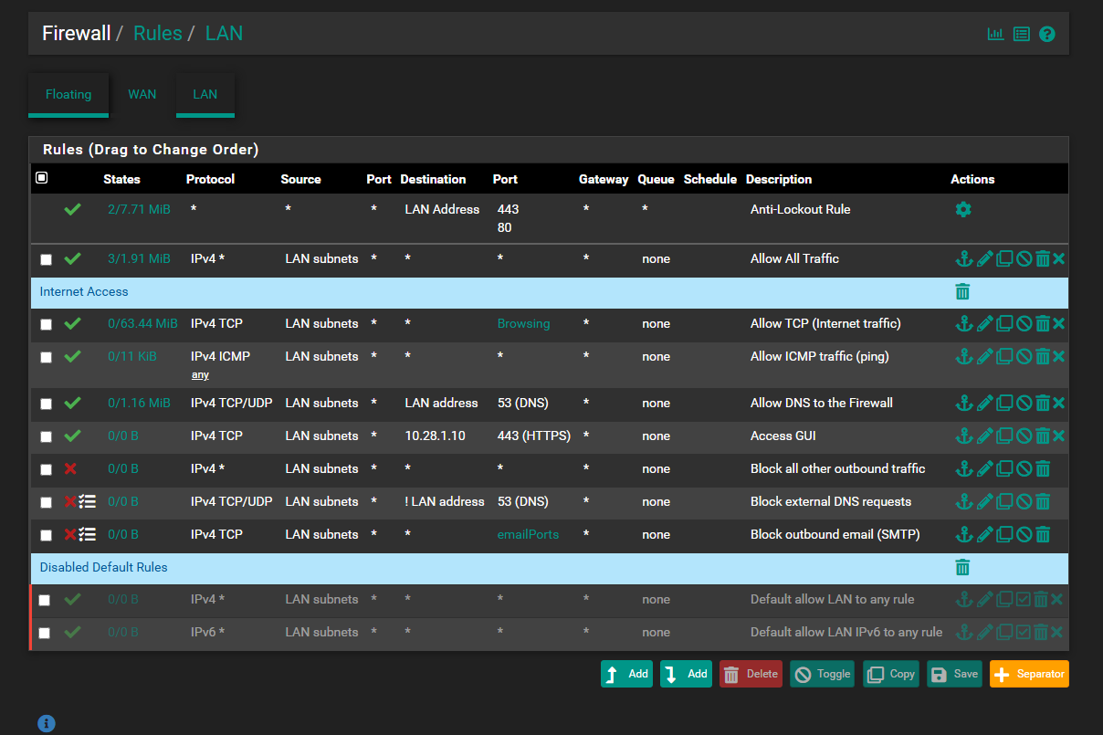

I am building a home router/firewall with pfSense to replace my Asus and TP-link all in one routers. I’ve installed it on an old Dell Optiplex and have managed to get it up and running, but have some questions about firewall rules.
The Browsing alias is ports 80,443,8080,53. The email alias is ports 25,465,587. Everything was going good ( I had internet in a browser and in Powershell), but when I tried to run other apps they would not connect to the internet. Two apps that I tried this morning that didn’t work was my trading app Ninjatrader and my vpn client. They work fine after I added the Allow All Traffic rule. My question is how do I configure a rule or rules to allow other apps without allowing everything.
Should I run netstat -b and just create an alias with all the ports that my apps are using and include that in rule? Or am I just being to anal, from what I understand pfSense is stated, so if i’m understanding that correctly it will only let traffic pass that my apps asked for anyway and the Allow All Traffic rule is good enough. Looking at netstat -b it looks like all the apps that I currently have running are using ports in the 52,000-53,000 range.
Maybe I could create and alias with that range of ports? Seems like a lot to have to troubleshoot any new app I might install to find ports and make a new or modify a rule every time.
I guess I’m looking for advise on which way to go and general firewall rules best practices.

The easiest way to check why something isn’t working is to check the firewall logs which you can filter to make it easier to find what you’re looking for. It’s always worth enabling logging on block rules for this reason. Your VPN won’t work because you’ve only allowed TCP Web ports and the VPN is going to be using UDP and whatever port the server is using.
Re you 52-53000 range comment. I think its too narrow. Besides specific application ports, its worthwhile whitelisting 49152–65535 as suggested by RFC 6335 and IANA as ephemeral or private ports.

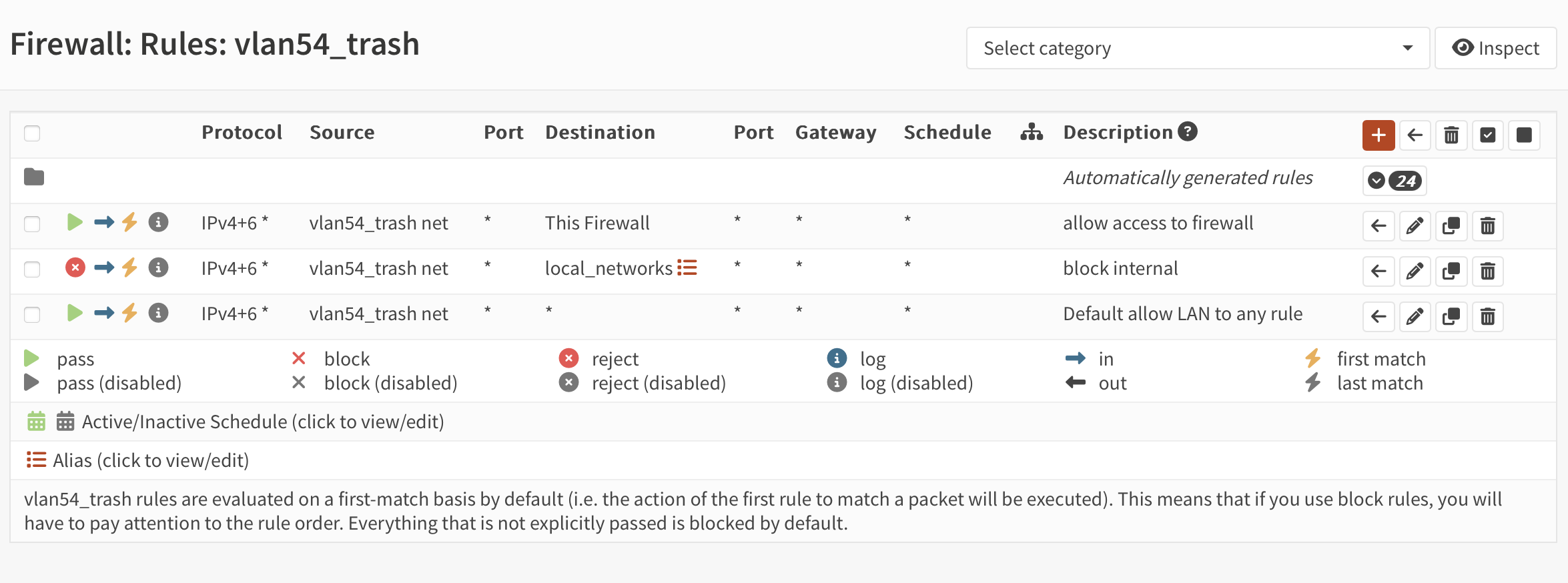

Here is a IMHO sleeker option. It also covers VLANs.
It is from OPNsense but pfSense is basically the same.
  • Rule 1:
    Is to allow all traffic to the Firewall itself. That allows for stuff like DNS. DHCP is already enabled in the auto rules.
  • Rule 2:
    This is an alias of local networks (RFC 1913 and IPv6 static /56 prefix from my ISP). That way clients can’t talk to other VLANs.
  • Rule 3:
    Allow everything. Since Firewall rules are “first catch only, top to bottom”, this will allow everything that was not blocked before and should always be the last rule.
    IMHO there is not point in opening single ports for outgoing connections.
That is basically how all tutorials tell you to setup firewall rules and IMHO the way to go.
@paws thank you very much lots of info!
After I posted I did change the Allow All Rule to open ports 52,000-54,000 and everything is working right now.
If I’m going to have all those ephemeral ports allowed why not just allow everything, kind of like what @ThisMightBeAFish says below?
Do I even need those three block rules I have at the bottom? I do want to keep it simple, and I’m going to have VLANS also. As for my vpn, I signed up with AirVPN for 3 months to test them out. I have their client “Eddie” on my pc right now, but I’m trying to put it directly on pfSense so I it will cover the whole network, or most of it anyway. It seems pretty involved and the newest guide I’ve found is from 2021, so a little outdated. Still a work in progress.

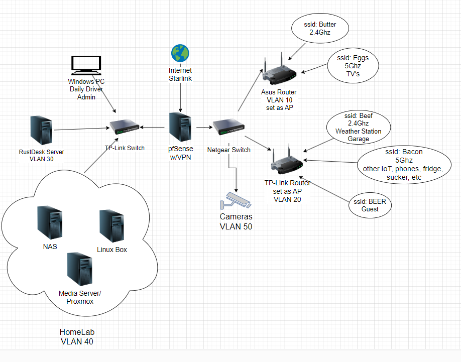

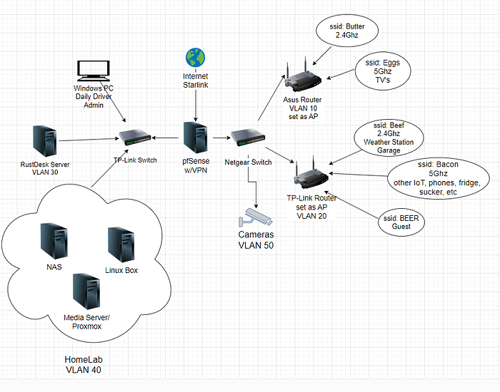

@ThisMightBeAFish Thanks for your input! I do want to keep it as simple as possible while keeping good security. I do want to create VLANS and It looks like the only block rule you have is to isolate the VLANS right? I don’t know if this should be a different topic but here is what I think I want my network to look like. Any recommendations from anyone would be welcome.
No, they do absolutely nothing there. Because they are at the end and by default everything is blocked in pfSense (but there are some automatic allow rules like DHCP).
VPNs are a Tunnel. Tunnels don’t offer any privacy advantages, because they only move your entry point to the internet. Companies like NordVPN are basically a scam, that is why their biggest spending is in marketing.
That is correct.
