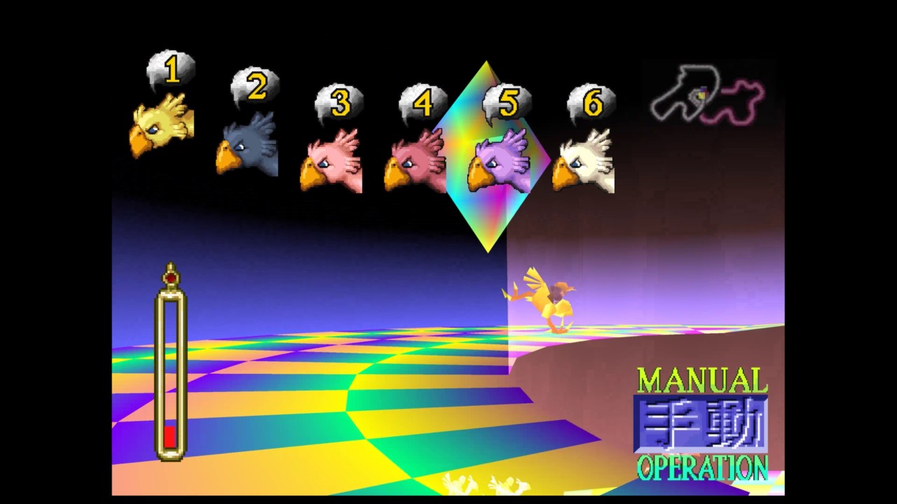

Currently I can do 4k recording, but it requires me to use the Ultra Fast Preset with CRF 18-20 I believe, and it uses 7 cores/14 threads, OBS scales great with cores. Here’s my current footage, it has some compression artifacting.

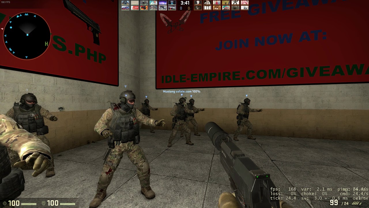

Thanks, I assume that was Very Fast CRF 18 or better for the 4k CS:GO recording?
Wonder what the exact settings are, but it looks solid enough for sure just using “Indistinguishable”
