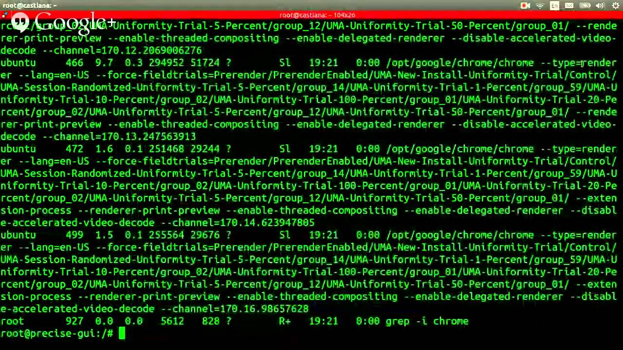

I started watching this video some time ago, but haven’t been bothered enough to finish it yet:

So I was thinking last night about the application container and watching that video at the top where he has a Ubuntu system with Chrome and Steam in a Container working. I now have the idea to have a base Antegros system install with Gnome and Chromium. Say I want to setup and mess with Git I will setup a container and setup Git in the container and if i just bomb the setup maybe be able to destroy container and start over again without having all these files and packages installed to my base OS. This is something I have thought of for a while without the knowledge of how to efficiently do it. I feel in my learning on Linux that I will install and try something and mess up the setup or run into an error or just not like the program and after a few months of this makes me feel like my system is cluttered with unnecessary junk and not everything gets removed when uninstalling package. This is something I am going to work with and see if it works like it is running in my head.
Any feedback of pros and cons on this approach? Git may not be the best thing for what I am trying to say but anyways let me know your thoughts on this approach.

Yea finish watching the video and they show separate containers running a single service and then you can interconnect those containers. I am staring at my terminal now about to start messing with it but got TeamPGP stream from last night going and keep getting distracted.

Which video were you watching?
It’s in this thread. LXC in the wild. It’s up there. That’s what we were discussing at the moment.
