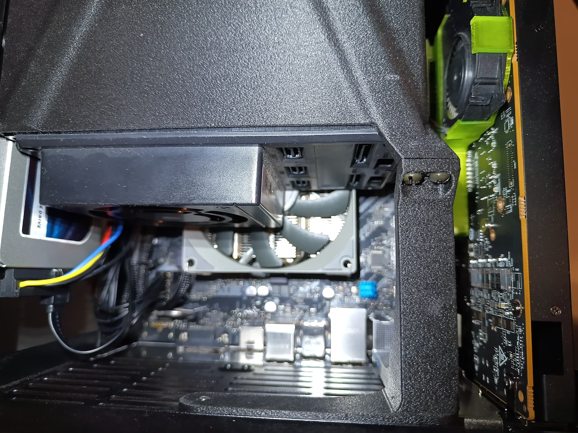

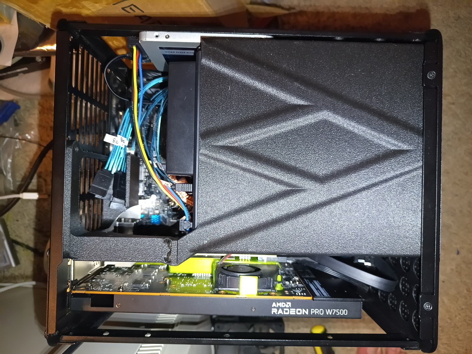

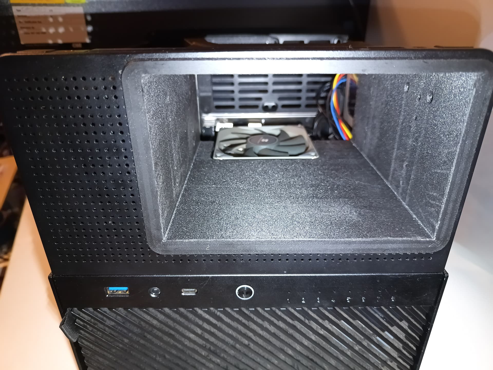

I added 2 5.25" bays to my Jonsbo N3, I thought I had clearance for the Thermalright AXP90-X36, and physically I do, but when I fully insert the 5.25" device into the bay it covers up part of the CPU fan and makes an annoying noise no matter the RPM.
I’m thinking I need a lower profile cooler, does anyone know of a good low profile lga1700 cooler?
Pictures to help explain what is going on:
5.25 bay empty:
With bay device installed, covering up part of the CPU fan:

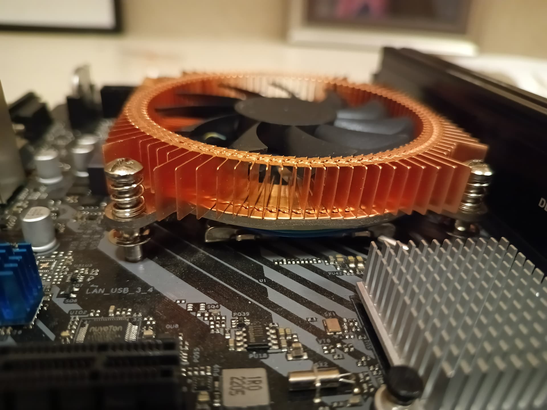

An update:
I got the chinese cooler and it is super low profile:
However I’m not exactly happy with it, I’ve noticed it makes a semi-annoying ball bearing noise when run above ~1700RPM; more of a buzzy noise than an imminently-about-to-fail ball bearing noise.
If the noise gets any worse I think I’m going to swap the cooler out for a Silverstone NT07… It’s still miles better than the buffeting noise the Thermalright cooler was making

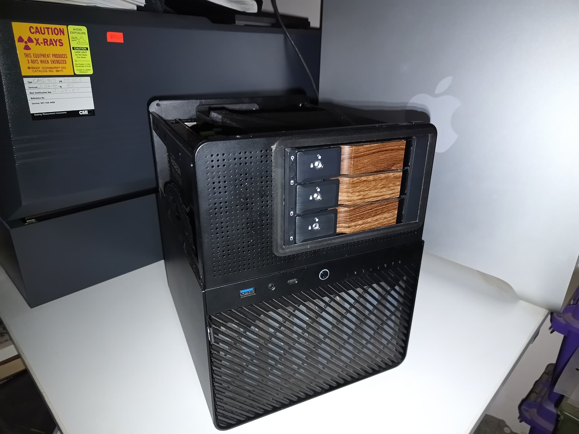

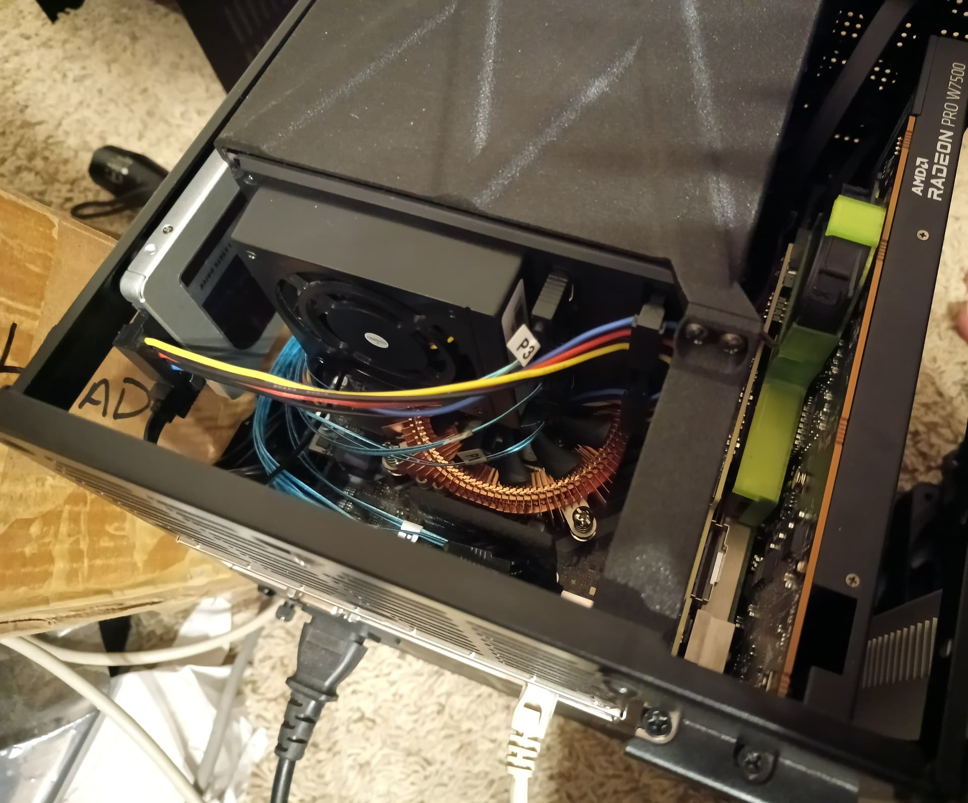

All the 3d printed parts are complete and fitted:
