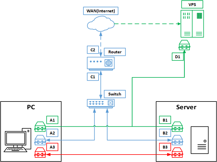

I’m having a hard time setting up my local LAN.
  • Network mainly consists of PC (Win10), Server (WinServer2019), VPS (Ubuntu 22) working as a VPN server. There are some other devices connected to the switch and the router, but those can be omitted.
  • Red link is 40GBit DAC connection (IPoIB), blue links between PC, Server, Switch and Router are all 2.5Gbit. Green link is the VPN connection (SoftEther server)
  • Server also has a DNS server for name resolving for apps hosted on it, so that they can be accessed by name on local LAN and VPN.
Right now, if I turn on the VPN connection on my Server - it starts generating around 50-60Mbit/s of downlink load, while nothing actually happens on it. Connection to the same VPN on the PC works ok, no weird loads generated.
I suspect that didn’t set up the routing and adapter settings correctly.
What I need is:
  1. When VPN connection is turned off - PC/Server connects to the WAN as usual.
  2. When VPN connection is turned on - PC/Server routes all WAN traffic through the VPN server.
  3. Both should still be reachable on the blue LAN.
  4. If red DAC is on-line traffic between PC and server should go through it (optional, this link being totally independent is ok)
IP addresses for adapters:
A1. - 192.168.30.XXX (VPN)
A2. - 192.168.1.XXX
A3. - 192.168.2.XXX
B1. - 192.168.30.YYY (VPN)
B2. - 192.168.1.YYY
B3. - 192.168.2.YYY
C1. - 192.168.1.1
C2. - DHCP’d from ISP
D1. - 192.168.30.1 (VPN)
VPS global IP is (as an example). - 10.10.10.10
What must I do for all of that to work properly?

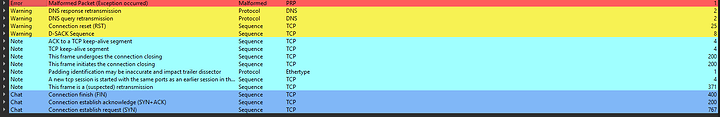

Wireshark error log looks concerning:
VPN interface log:
Physical LAN log:
Same log, but with VPN turned off:
Physical LAN log:

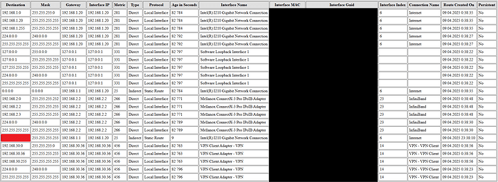

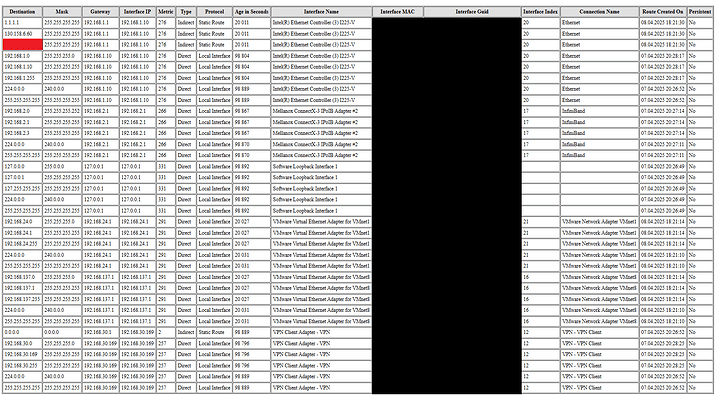

Server's routing table
PC's routing table
Red cover - is VPN server’s global IP.

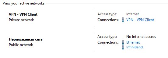

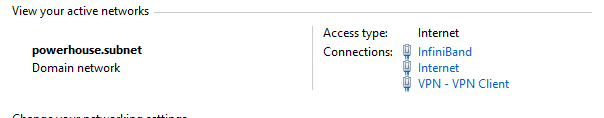

Could this be caused by the Server having domain services enabled? It seems like it connects all the adapters into one “domain network”.
PC Network and Sharing Center
Server Network and Sharing Center
Capturenet
Again im not an expert on all things windows, hopefully someone can correct me if im wrong here, but domains are a windows thing for windows active directory. I believe your powerhouse.subnet is the domain network containing the ips of all netorks that the domain applies to, or in other words the ip ranges. so 192.168.30.0/24, 192.168.1.0/24, and 192.168.2.0/24 networks that span across three adapters. An active directory server can set firewall rules for windows computers inside its domain. So yes if your using active directory and have set rules to apply to users or computers, it can be changing your firewall and routing.
The bottom line is no it should not be directly responsible, and the subnet is not a bridge network adapter, or we would have seen it have a defined ip and routes in the routing table.
