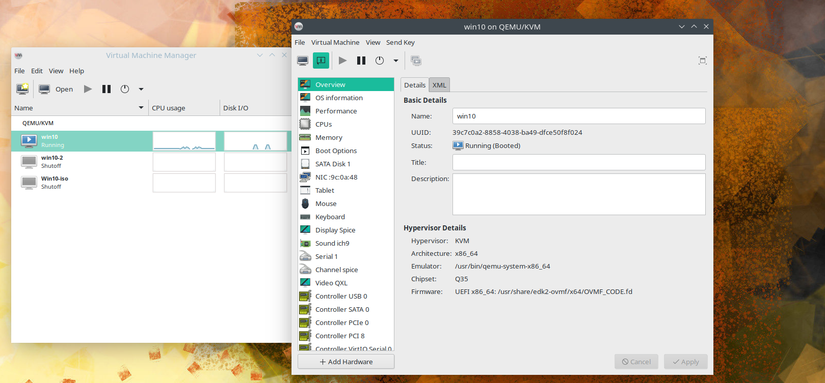

Regarding the problem - I believe your Windows installation is using UEFI and it is either not located on the same drive or you have created a VM that does not support UEFI.
Please fill in the following:
  1. Does your PC boot into windows right away and shows the wheel of death? (Rotating dot pattern)
  2. When you created the VM in the virt-manager, did you select that it will be Win10?
  3. In overview of the VM, does it show: Chipset: Q35 and Firmware: UEFI
  4. When you installed Win on your computer did you have any other drives in it?
  5. Is there a small 100MB partion on the SSD you are trying to push?

  3. yes

ok i just checked and the Firmware was on BIOS, changed it to UEFI and now i get this from running the vm:

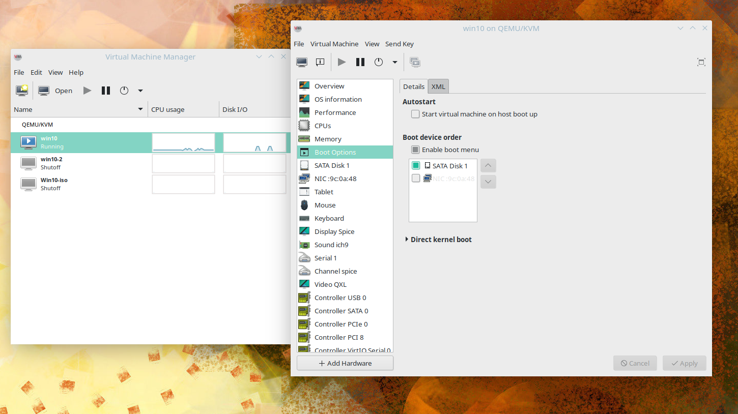

Now that is on UEFI it matters how you passed it and what is setup in the boot section of the virt-manager. Try to pass the entire drive as raw using SATA (For sata drive), then make sure it is selected for boot.
it doesn’t matter, even if i pass the entire drive as raw using SATA its still gives me UEFI Shell.

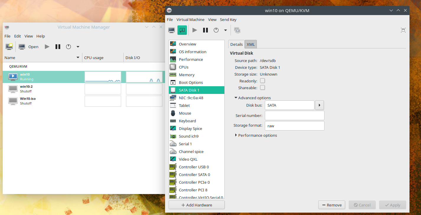

look at the settings:
Imgur
Imgur
Imgur
this is the XML:
> <disk type="block" device="disk">
>   <driver name="qemu" type="raw" cache="none" io="native"/>
>   <source dev="/dev/sdb" index="1"/>
>   <backingStore/>
>   <target dev="sda" bus="sata"/>
>   <alias name="sata0-0-0"/>
>   <address type="drive" controller="0" bus="0" target="0" unit="0"/>
> </disk>
