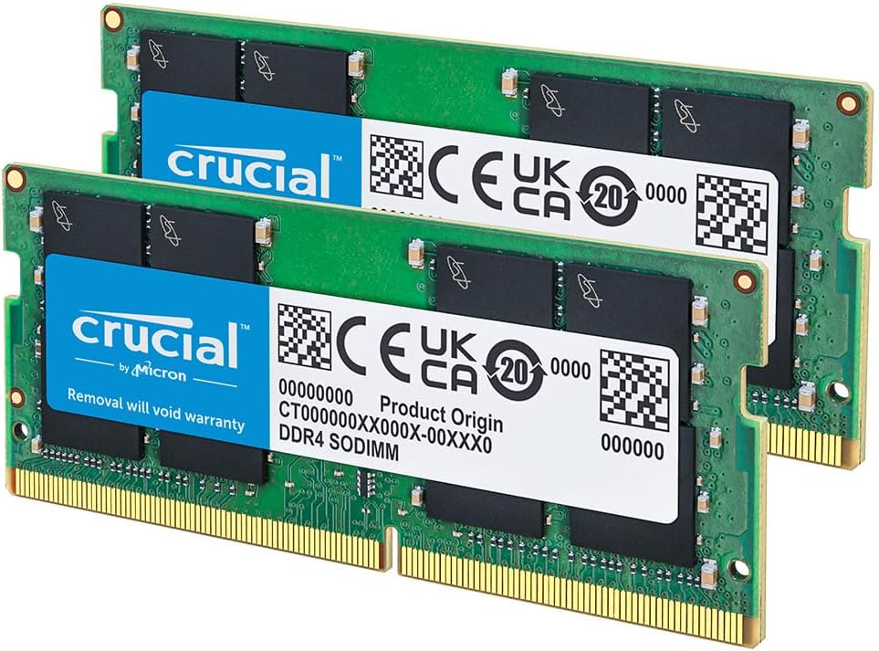

  1. can i upgrade the um560xt with a Timetec 64GB KIT(2x32GB) DDR4 3200MHz 1.2V kit

Probably. I put this Crucial 64GB kit in mine:
No, not really. Extra no if you’re also going to mount a 2.5" drive inside it.
Probably? I’ve had TrueNAS Scale and Debian 12 on mine so far.
