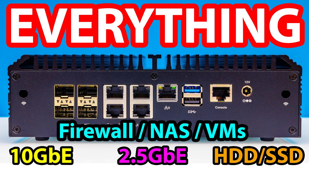

Oh yeah, I forgot how much HDDs do draw. I retired my 4x1TB redundant NAS two years ago after seven years of faithful service in favor of two 1TB SSD JBODs + Backups and haven’t looked back since, though I am thinking of upgrading to a mirrored 4TB all NVMe setup. That’s me though.
Also food for thought, if the OP or anyone else want a less jank setup but with the drawback of a less capable CPU there is also the Asustor Flashstor 6 for $449, it is less flexible but draws between 13W-24W when all SSDs are installed. With 4TB SSDs going at $200, that is slightly less than $1700 for 6x4TB of raw storage, and the same money will buy you a 6x8TB in a year or two. Not a terrible deal if we are looking at the $1500- $2000 range, though yes, you can buy 4x12TB HDDs + NAS unit for the same price.
