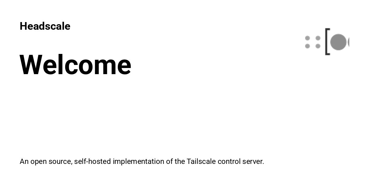

Not sure about how to get around SSO, you might look into running a headscale node on a small VPS but this is a significant maitenance overhead in my opinion. You don’t even use github? Or refuse to use a throwaway account to register for Tailscale?
