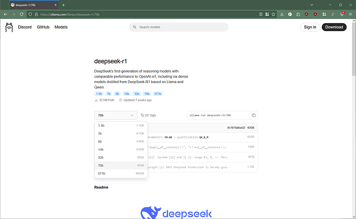

I would like to stretch this guy’s legs, my AMD Radeon RX 9070, with a local LLM. I followed this guide on installing DeepSeek R1 with Ollama and I chose the 70billion parameter model. I’m not sure if that’s too much, but it seemed rather slow to respond to my “Hello” prompt.
How can I be sure it’s using my GPU? Also, should I go down to a smaller model with this GPU; I realize it’s not a super high-end GPU. Honestly, I googled how to run DeepSeek R1 locally and chose one of the first links I came across. So is using Ollama the way to go, or might there be other potentially better ways to run LLMs?

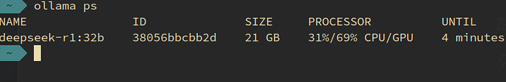

When you’re using ollama, you can use the ollama ps command to determine the status of it. Here’s an example of me using deepseek-r1:32b on my 6900xt, which also has 16GB of VRAM.
Because the 70b model is 42GB in size, you’ll likely need 48GB at minimum to run it entirely on GPUs.
Given that you only have 32GB of system memory, you’ll not be able to run 70b models with any amount of efficiency, because for each token generated, it will need to swap in and out the different sections of the model, which would result in 1 token every few seconds. You’d be better off measuring in tokens per minute, rather than tokens per second.

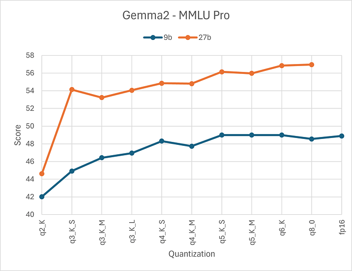

Gemma 2 and picking a model at varying parameter sizes and quantization levels
Gemma 2 is a pretty good example of having lots of quantization and parameter counts.
To illustrate this process, let’s assume that there isn’t a performance drop off at higher quantization levels.
Technically it drops off after q5
Interesting Results: Comparing Gemma2 9B and 27B Quants Part 2 : LocalLLaMA
interesting_results_comparing_gemma2_9b_and_27b/
Given the OP has a 12gb, I would start with the base 27B model as the size is only 16GB. If performance is good and fully utilizes the gpu enough stay there. Otherwise drop down to the 9B base model.

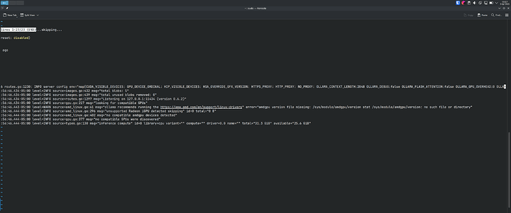

Need to see the ollama daemon logs.

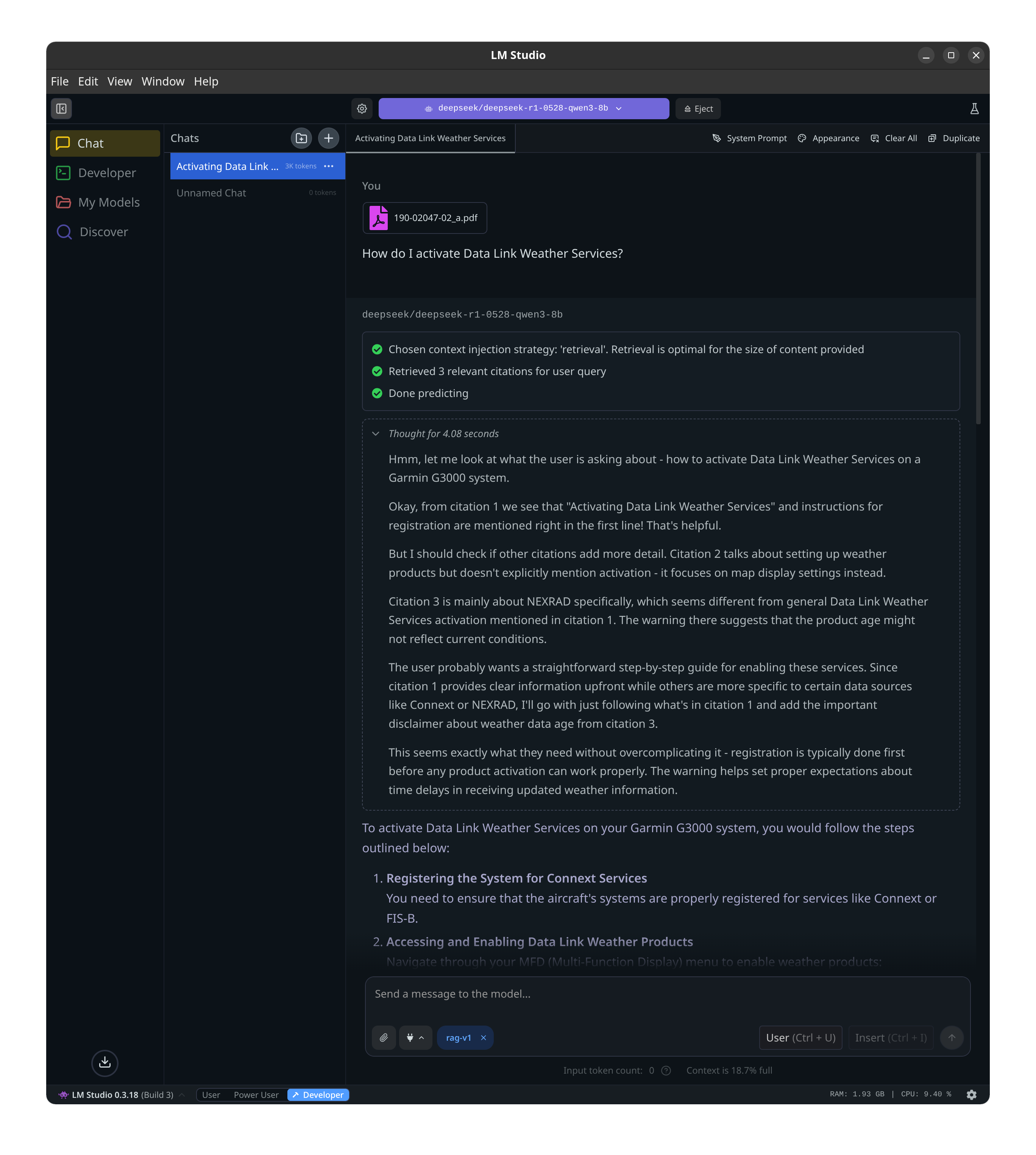

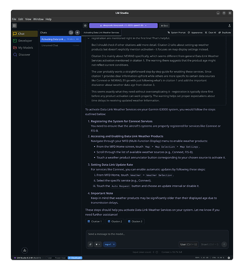

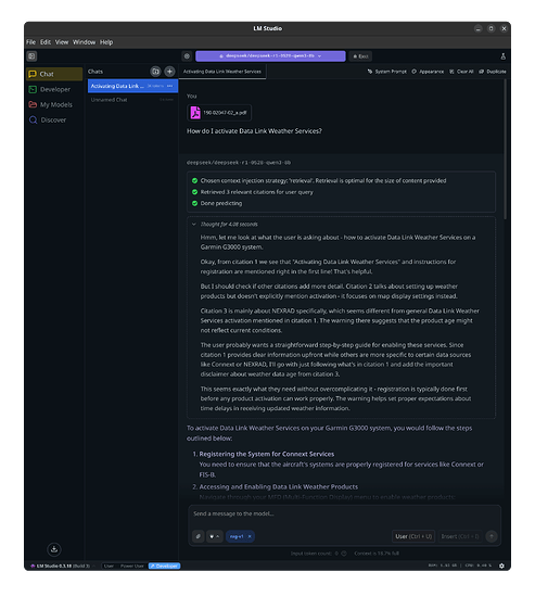

I would use LM Studio and an 8b model. If you need more specific answers from it you can always give it a document to retrieve answers from as I did here. I uploaded the manual for the Garmin G3000 Pro Touch avionics and asked it a question about it. It gave me a reasonable answer. I could get more specific if I needed more info on any particular step. The benefit to running a smaller model on a consumer GPU with less VRAM is 1) the LLM will run faster on the GPU and 2) you can have a larger context window in which to operate as that also takes up VRAM.
edit: I have a 7900XTX with 24GB of VRAM and this ran at ~51.25 tokens/sec
