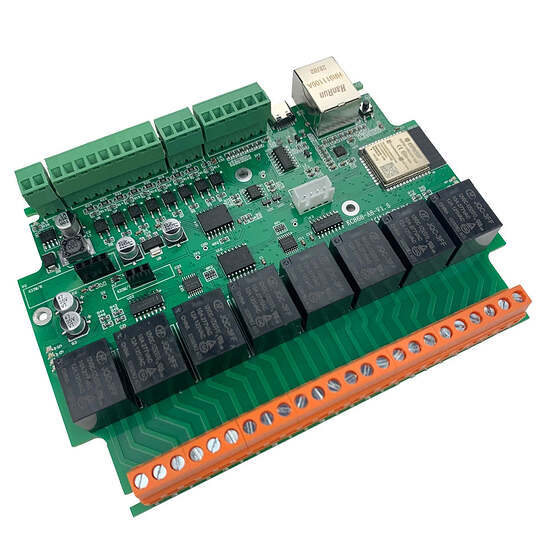

I use these for low voltage control.
They work with ESPHome and HA without issues. Wire the relays in to turn the valves off and on. I use them for lights, electric water valves, or anything else.

That seams to be kinda like what I’m looking for
these relay-driven io-cards are pretty nice. if you want more connectivity check for raspberry-pi hat and raspberry pi zero. this solution is more expensive than the very good tip from @Porch but you can run a full independent linux on them. with it you can create internet-connectivity with access from your smartphone etc.. it’s more expensive but way more flexible when it comes to automate your home. also check for tags like grafana and home assistant. there are a lot of ideas already fitting your needs and that you can adopt.
I used to use Rhaspberry-pi with relay boards, but then that a whole OS to manage and it was overkill for O/I. All I really need is to get remote O/I into HA and ESPHome does a great job of that.

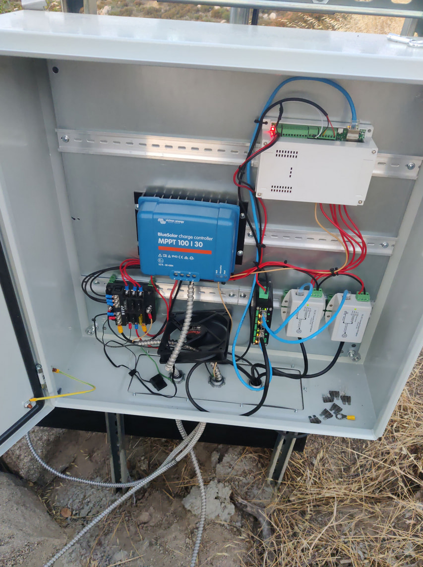

I have standardized on the KC868-A8 around the home and property. I think I have 12 or so running.
This one is in a box on a hill that has some wifi gear and a CCTV camera. The KC box measures temp, battery voltage, and lets me hard power cycle things if stuff is not responding.
KinCony has some example yaml files files for ESPHome on their website. Note that it does support BS18S20 temp sensors, but the 1-wire bus does not like distances more then a few feet, so don’t plan to use it for remote room temp sensors.
