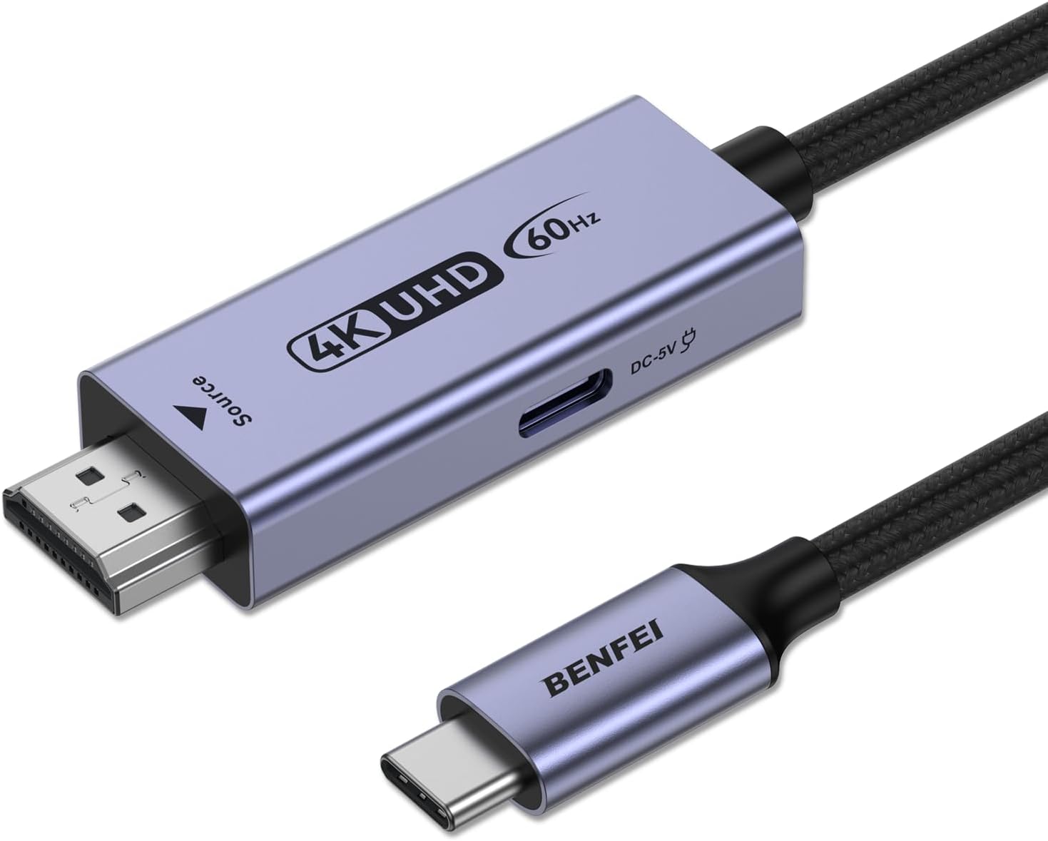

Try searching for HDMI (Source) to USB-C (Display). They normally have a USB and HDMI on one end and USBC on the other. Or a USB port on the HDMI end.
You’ll want a cable that’s specific to the data flow. I’ve used a few at work where the hdmi side is the output and the USB side is the input.
Yes. This is unfortunately the case, as USB-C utilizes the Displayport protocol.
Now, this is important because it has bitten me too in the past. Most HDMI → DP adapters have a fixed refresh frequency and resolution. Make sure the resolution is compatible with your monitor.
Here is one for 4k@60Hz, but feel free to shop around:
