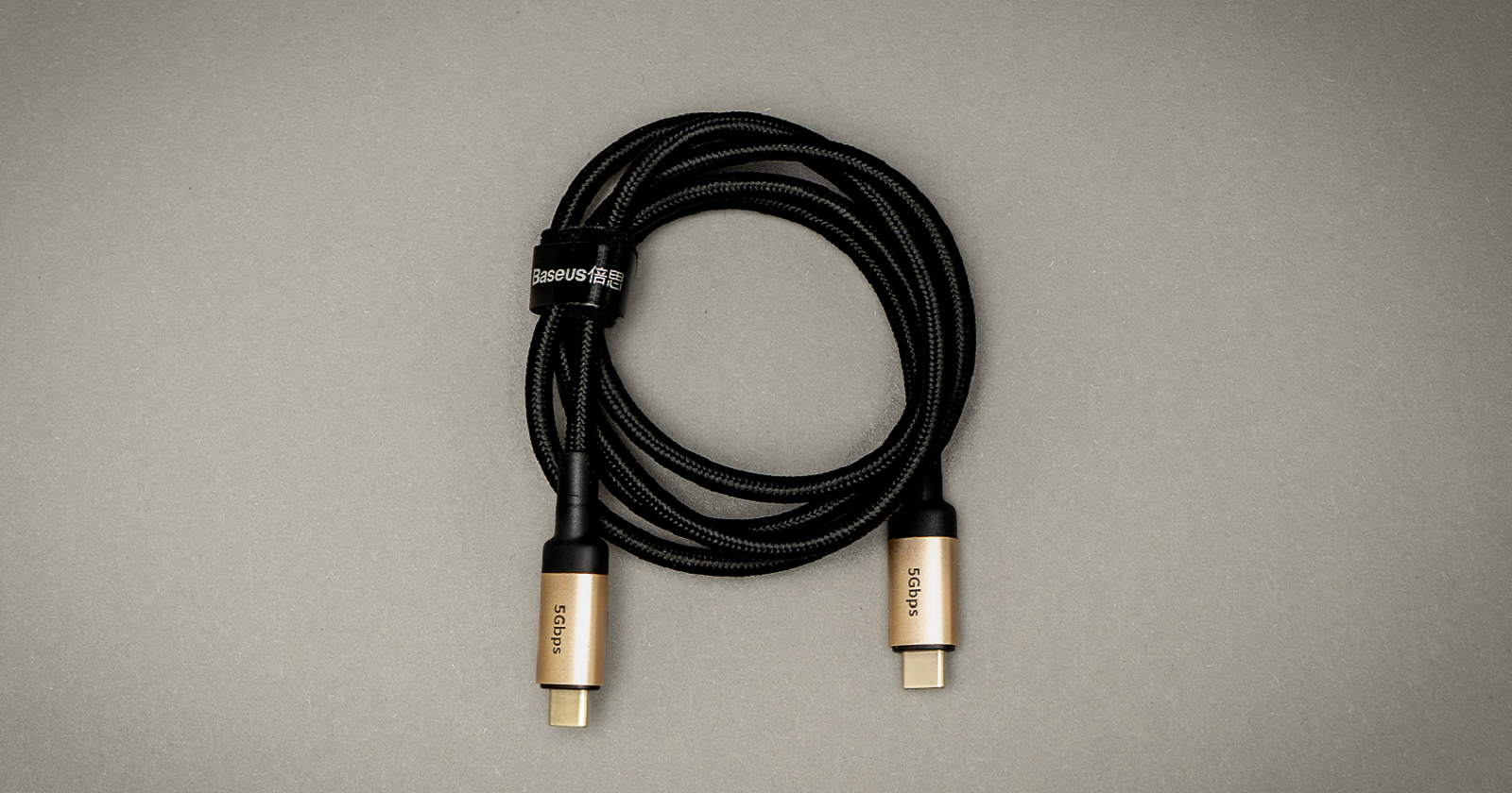

Also USB Type C can do display port I think, depends on your motherboard I guess though
Don't know if this actually works
http://www.j5create.com/our-products/usb-type-c-adapter/jca141.html
I do have usb type c and DP1.2 on my motherboard so I could try that.
