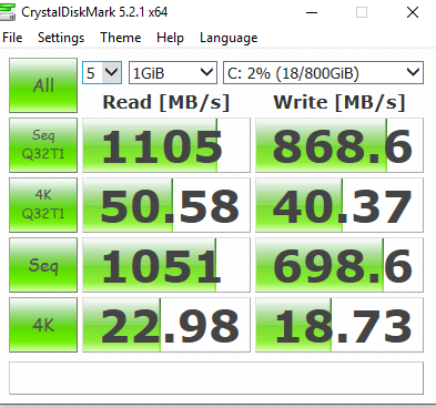

i kinda agree, depending on r/w frequency and amount being written. Things will go smoothly if you have cache, and you are able to save that data before filling it up.
But if your data is explosive, like 2-4GB and you want it fast read/write, and there’s couple minutes of space most of the times between the work loads then cache makes extreme difference.
( 2-4GB is example, if you have memory; lets say whole server is for raid storage why not use 60% of that memory as cache)
then again we have different types of caching, and what you consider ‘safe’.
If you don’t mind loosing changes or don’t think you’ll ever loose power, I recommend using unsafe or writeback caching. This will make huge difference. Data will be kept in memory until its written to hdd’s.
in terms of typical production environment, many consider writethrough as best option, its usually default cache mode. As its considered as safe. Performance is reduced because there is no write cache.
What are the gains?
Reading and writing 1GB to a slow 5200RPM drive with its own 64mb internal cache, using unsafe caching, gains are almost 10x in performance for a single drive.
You will benefit from raid 0 in terms of performance but you risk loosing data, so raid 5, 10 is one of the best in production adoptions. Again if you don’t mind loosing data raid 0 is for maximal performance.
Having cache for read only is good approach, put re-usable data that isn’t changing a lot on faster storage, and or with better caching. In terms of read performance you should have cache.
In any case, if your storage is poor; caching is one of the best options to alleviate the problem.
