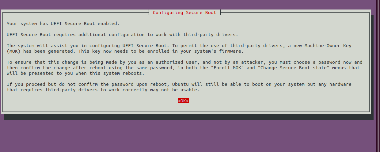

I’m currently trying to install Nvidia binary driver 415 but I’m having some problems.
I believe the issue is secure boot related because It asks me to enter a secure boot password that I will use after I reboot, but when I reboot I don’t get prompted to enter a password.
Ubuntu just boots like normal, but the driver doesn’t get applied properly, I’m getting graphical bugs, low resolution and other such problems.
What can I do to fix this, setup secure boot and install the Nvidia driver.

I don’t see an option about kernel module. At the end of package installation this is all I see.
