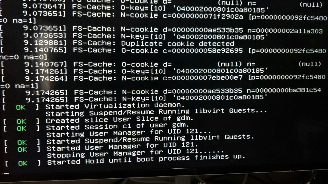

That all went fine but when i actually try to boot with the new kernel my system freezes half way through the boot process. Specifically rite here: https://ss.brandon3055.com/7ee2a
I have no idea how to troubleshoot this issue so i am hoping someone here can point me in the rite direction.

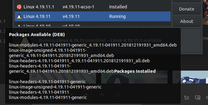

I should probably also mention that before acs i also tried updating my kernel to 4.19.11 via ukuu and that worked fine, in fact im running it now. so whatever is causing this must be a some difference between 4.19.11 and 4.19.11-acso
I did notice the generic kernel version has some packages that acs does not but im not sure if that is the issue.

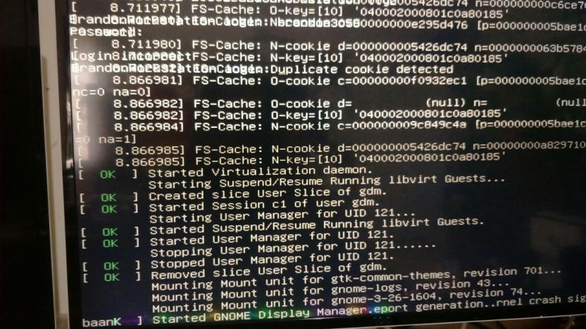

Also not sure if its relevant but i noticed the boot froze at a different spot this time

I don’t know the answer to this. You’d have to inspect the packages and compare. You may have multiple packages combined into one in the case of the acs version.

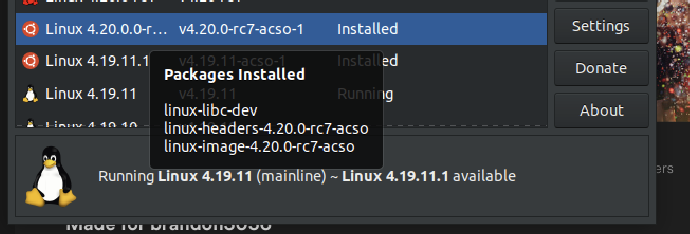

I will take another crack at this later. My next step (assuming no one posts a better idea in the mean time) will be to try with the latest stable kernel .19.11 (currently using .20-rc7) If that does not work i may try addressing the “Kernel configuration is invalid” error by downloading the source and running those commands ‘make oldconfig && make prepare’

Judging by the second picture it hangs when starting GDM and Gnome so might very well be the issue with gnome and GDM.
