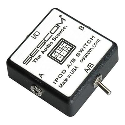

3.5mm jack switch, when I ordered one they sent me a RCA (red and white stereo) version on accident. I just used adapters to fix it. you will need a aux extension to from pc to switch (top port) and then plug in your headphones/speakers in the side ports.

Thank you all for the suggestions. I think i might buy the jack switch later. For now I have my headphones plugged into the blue port and speakers to the green port, I managed to tell the drivers that both ports were plugged into the front speakers. Now all sounds come out of both of them all the time, so if I want to use the headphones I just have to turn off the speakers.
