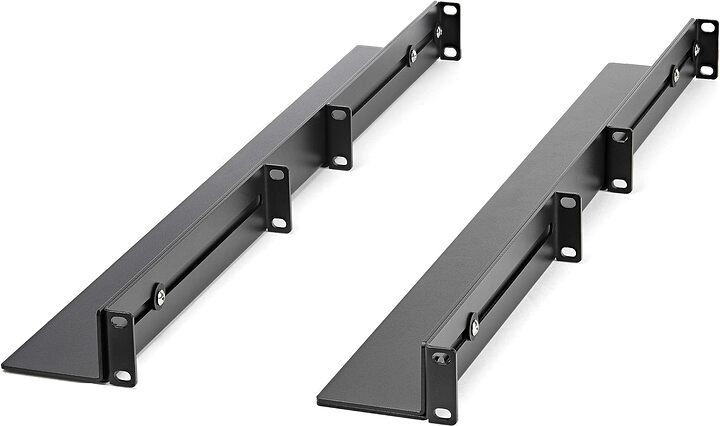

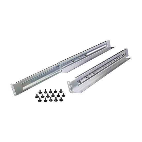

the ‘smaller’ cyberpower rack UPS do not usually include any rails but i would not mount them with out support. i always either mount it on the bottom of the rack so it sits on the inner rack frame, or buy the aftermarket UPS RAILS. CyberPower makes a rail kit, and it is included with their BIG UPSs, that you can buy seperate also. (i have like 100 rack cyberpower UPS and a LOT of desktop style UPS scattered around)
Two dumb question, but this looks like this screws in with rack nuts/screws in the front and back - I have an open frame rack am I able to screw these from the “front” of the rack holes in the back, or do these have to get screwed into the frame from the back (hopefully that makes sense).
Second, are you able to screw the UPS into the rack as well as the shelf? or just the shelf itself and the UPS rests on it?
ah thanks! I dont think there is a way to pout them on my UPS…oh unless I think they want me to unscrew from the UPS itself and screw back in with the rails.
