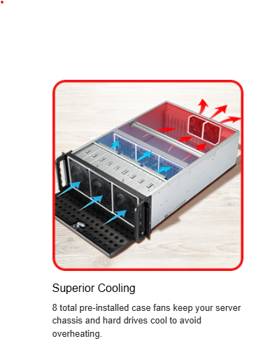

have seen this kinda thing when the hba/adapter is running too hot, or borderline.
That could very well be the issue. the drives typically run around 70 - 80*C getting even hotter under load.
I’m using
image_2025-04-21_210446083
Configured in the same manner as the image above shows, the only difference is that I have removed the front lockable panel to increase air flow.
This makes prefect sense. The drives work as intended when not configured in some sort of raid because the heat generated by one drive is a good deal less than what is generated by 5x3 …
I’ll look into better cooling options and get back to you with the results .
