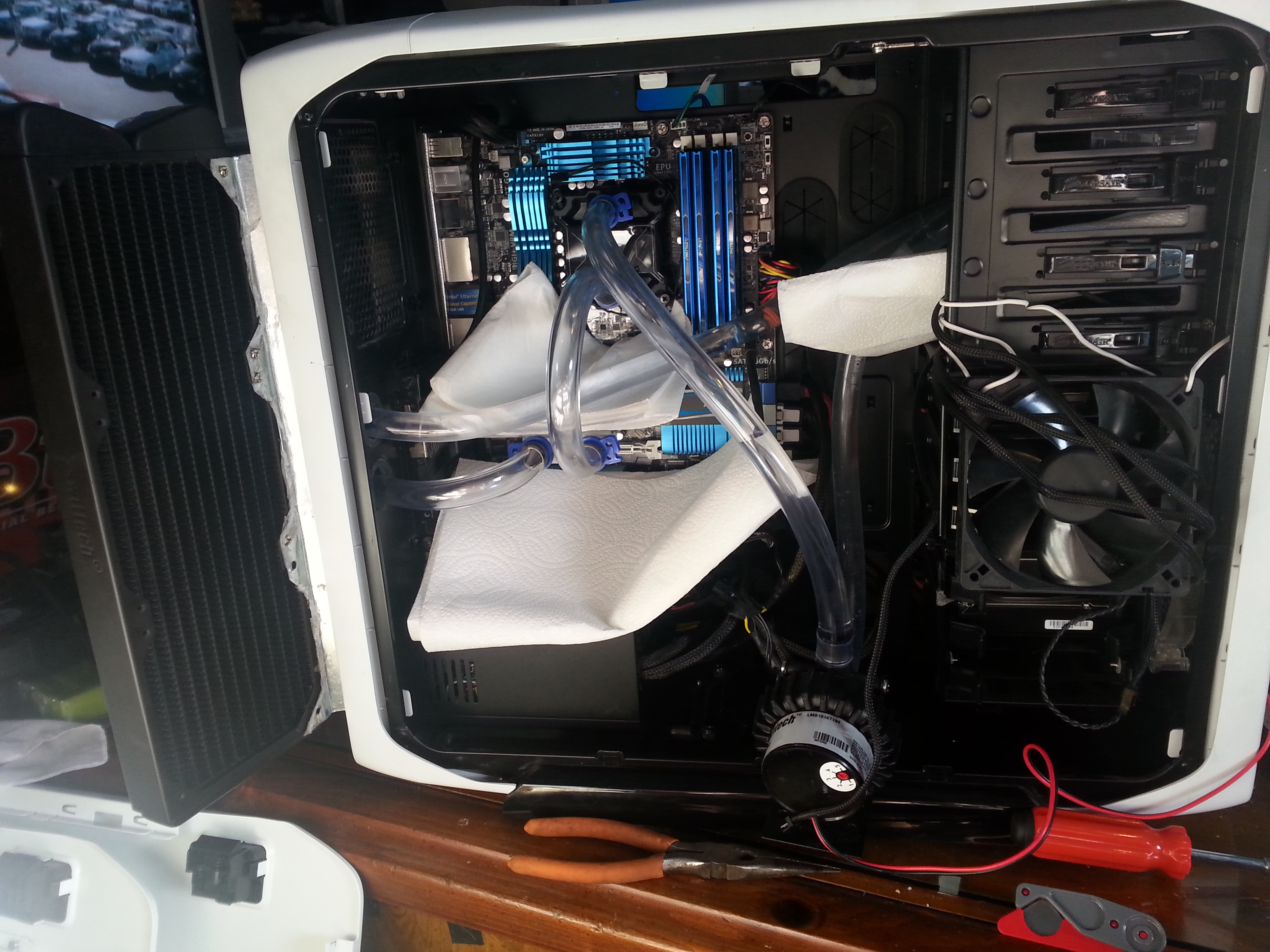

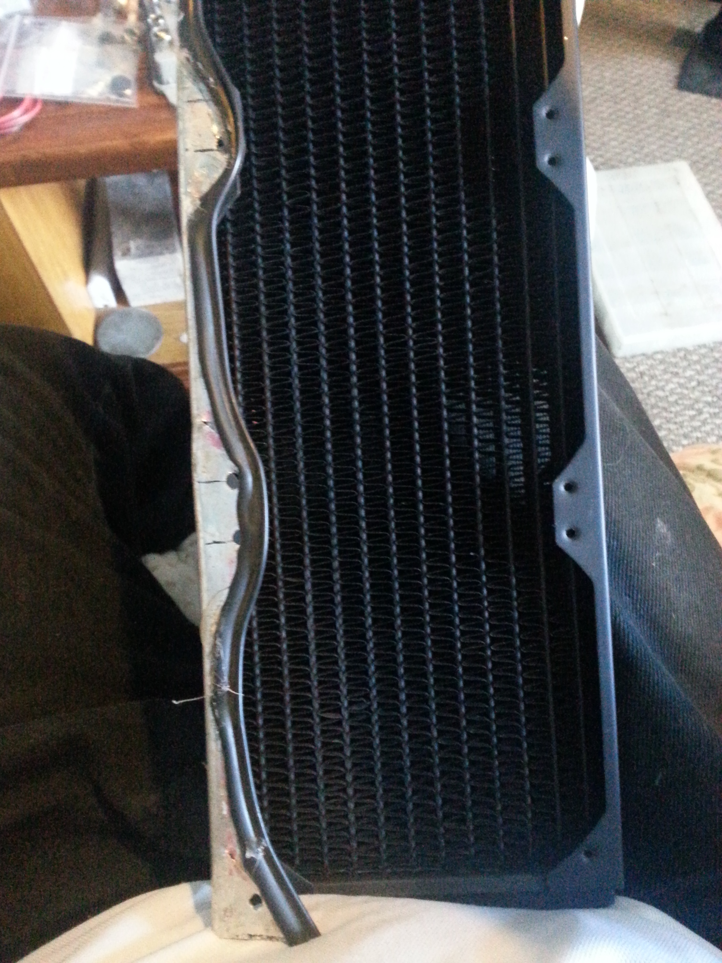

haha nice ghetto cooling :slight_smile:
polish it up and hide some wires, id charge double the msrp for that job
the back 2 rads are now on hinges, sitting pretty all symmetrical like.
they can fold flat to the sides of the tower
and that metal bracket on the gpu, was a d-wood bracket,
from the guy that NZXT based its design off of
(NZXT Technologies Kraken G10 Liquid Cooled GPU Mounting Kit)

again nice ghetto cooling :slight_smile: i lov ghetto cooling so much fun :slight_smile:
amazing what you can do with little money :slight_smile:
