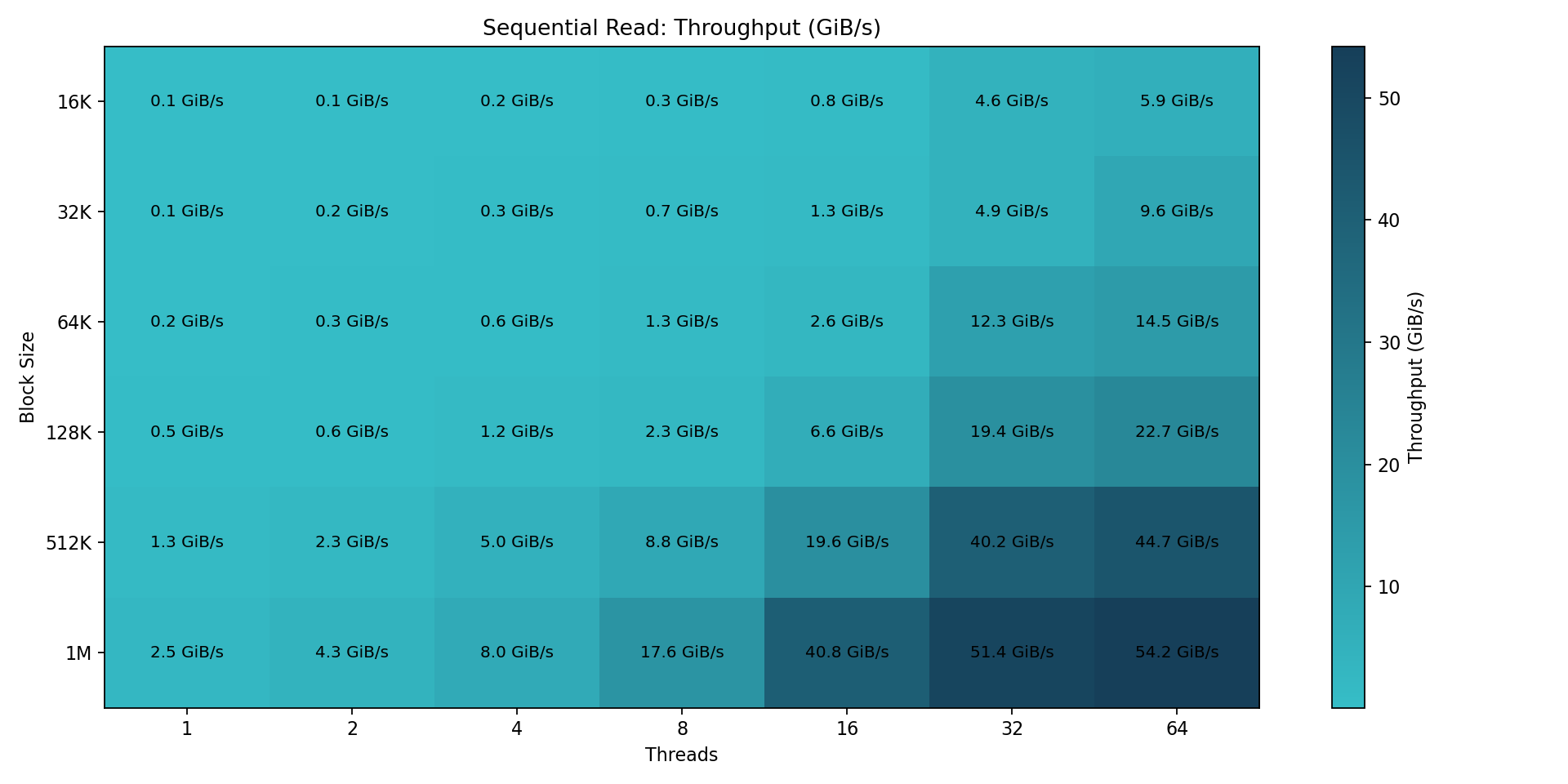

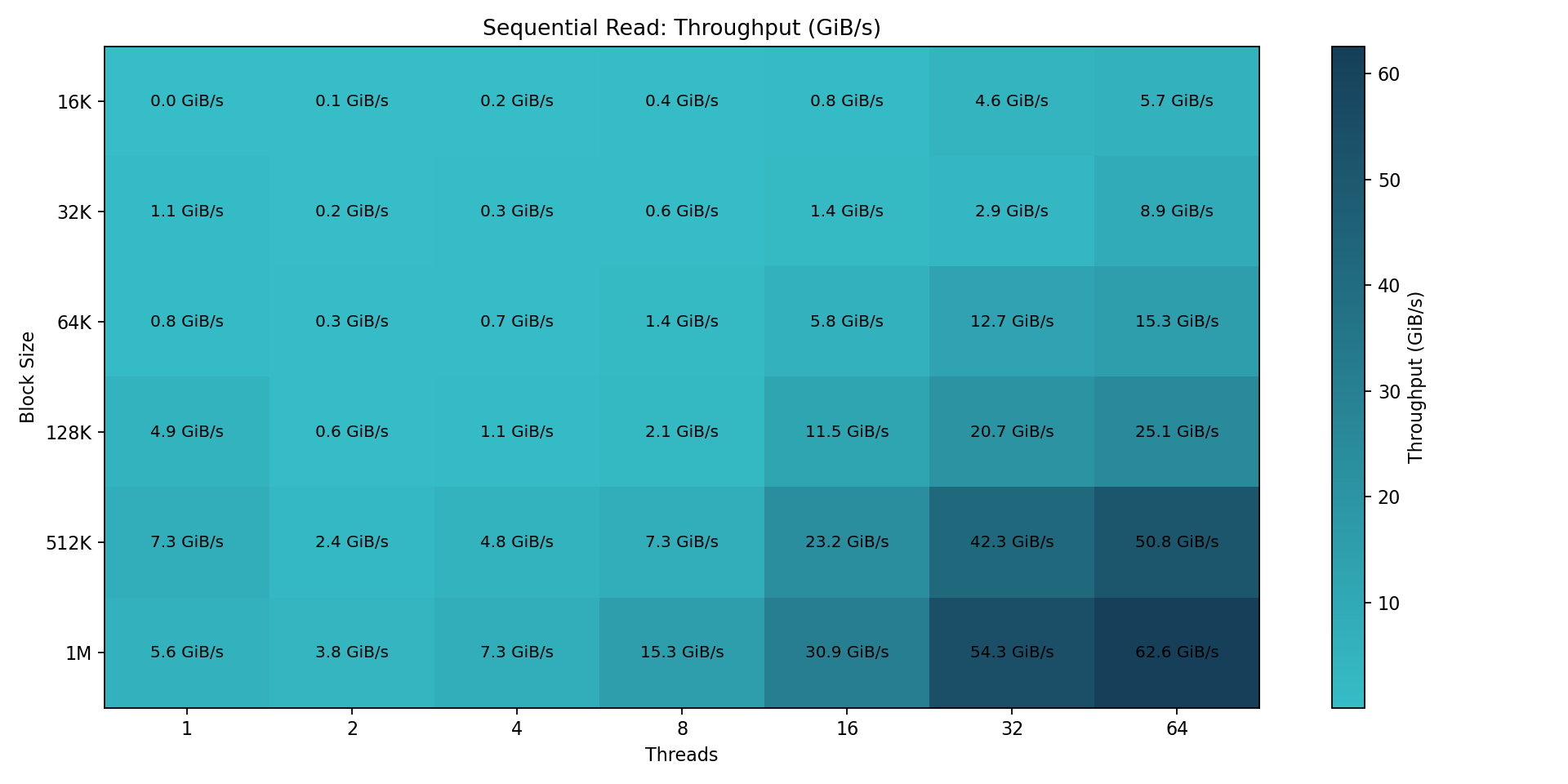

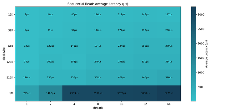

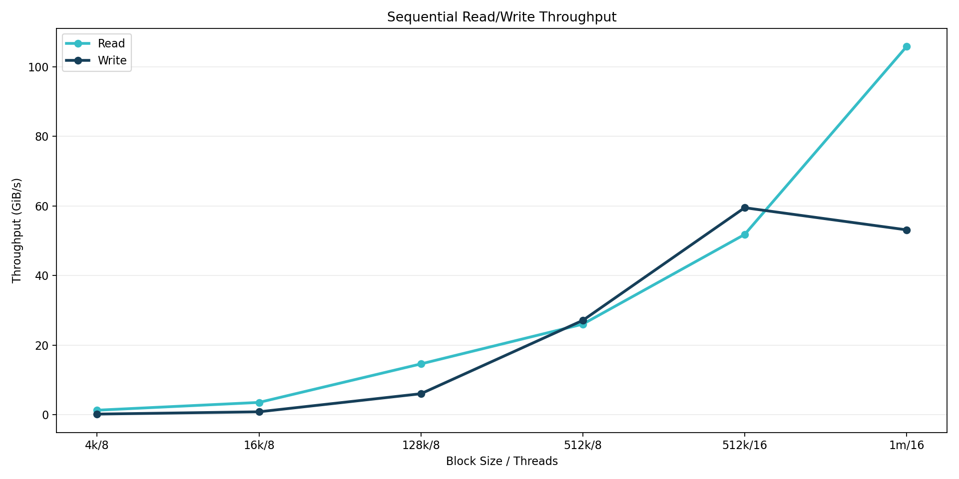

Raw Device Benchmarks
16 drive configuration (two NUMA node, no other background jobs)
8 drive configuration (single NUMA node)

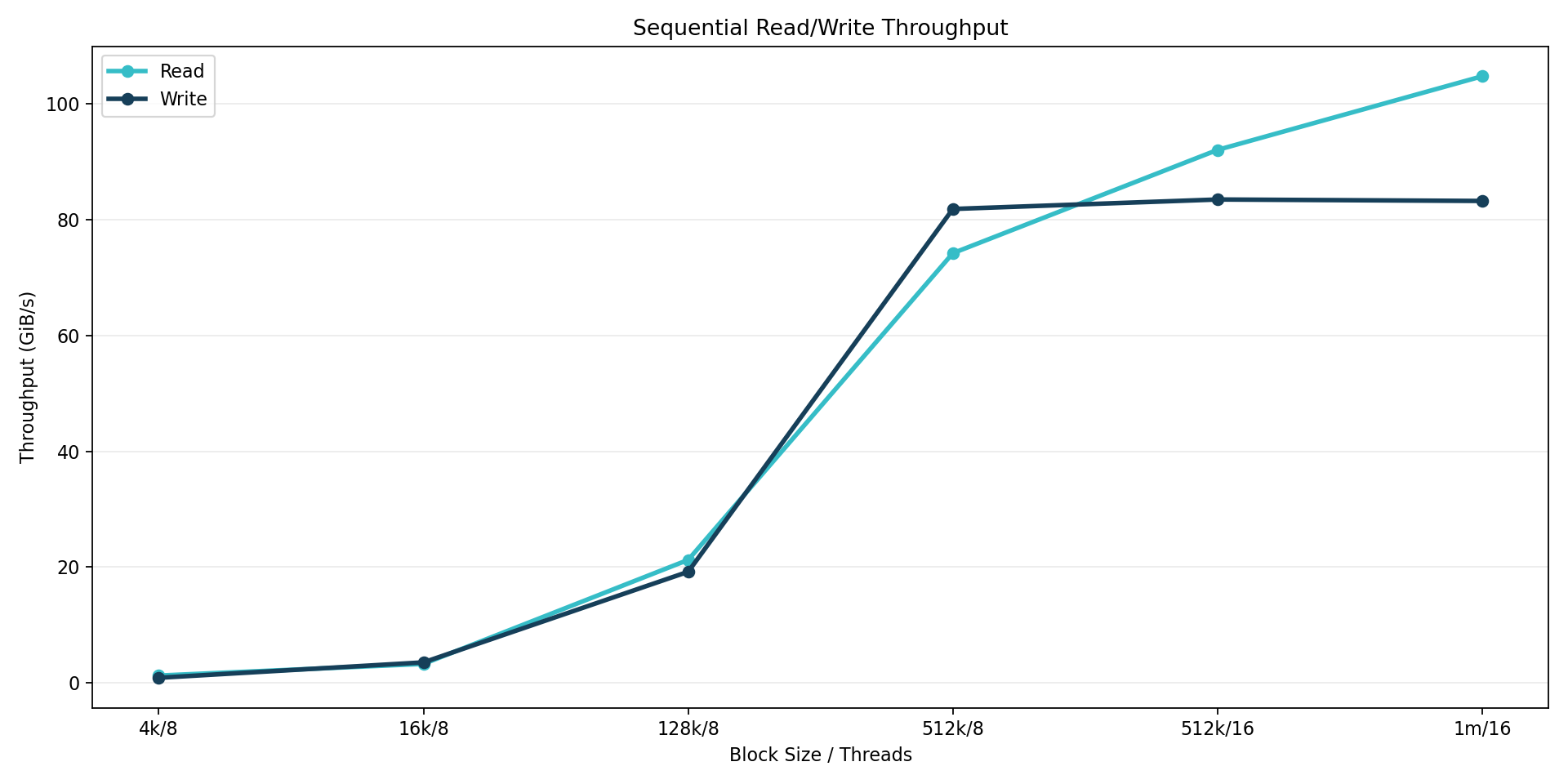

Peak Performance
Real-World

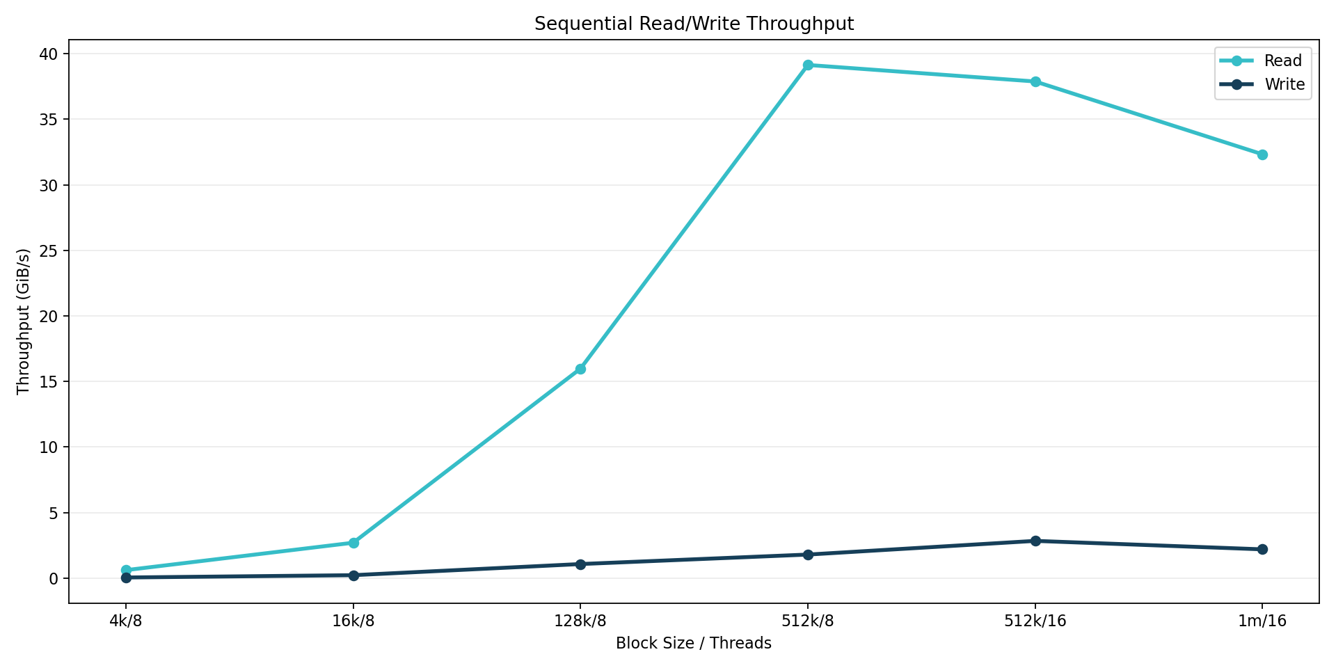

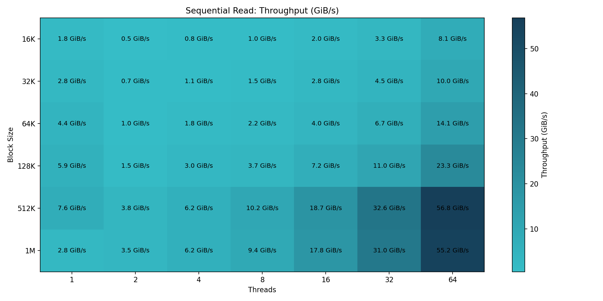

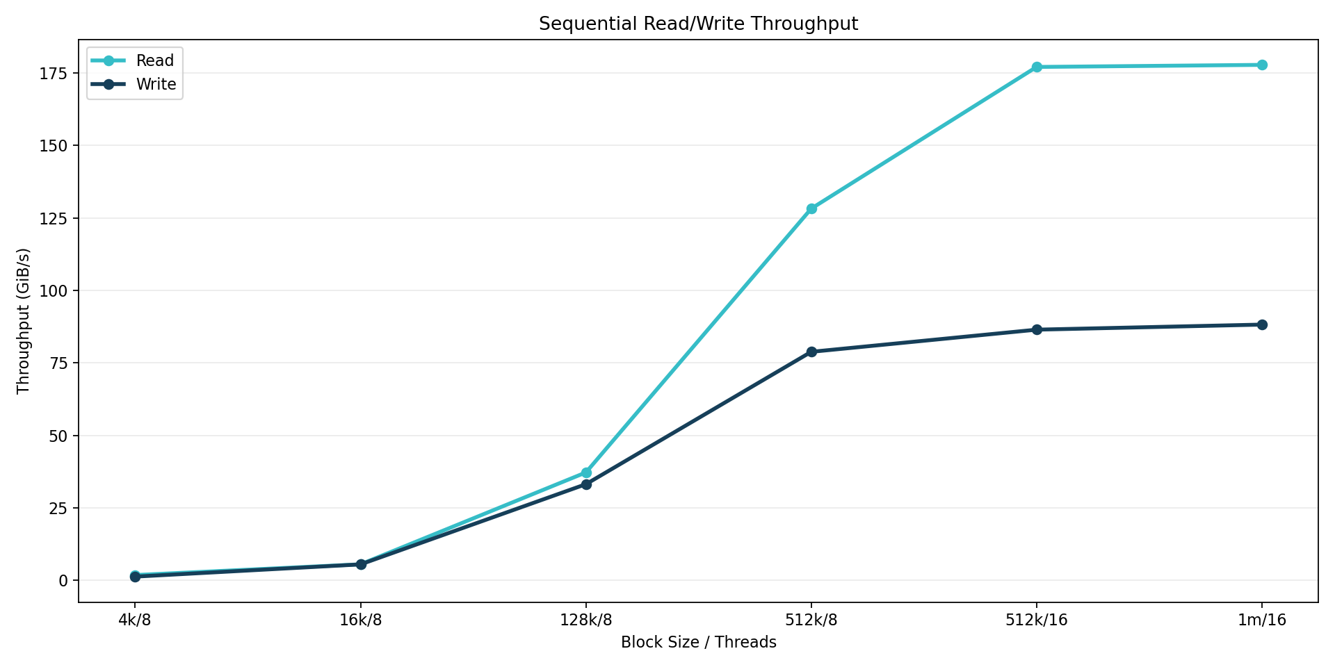

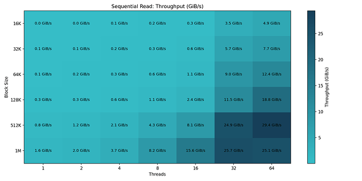

8 drive raid 5 (single NUMA node)

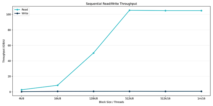

BTRFS Filesystem (8 drive)

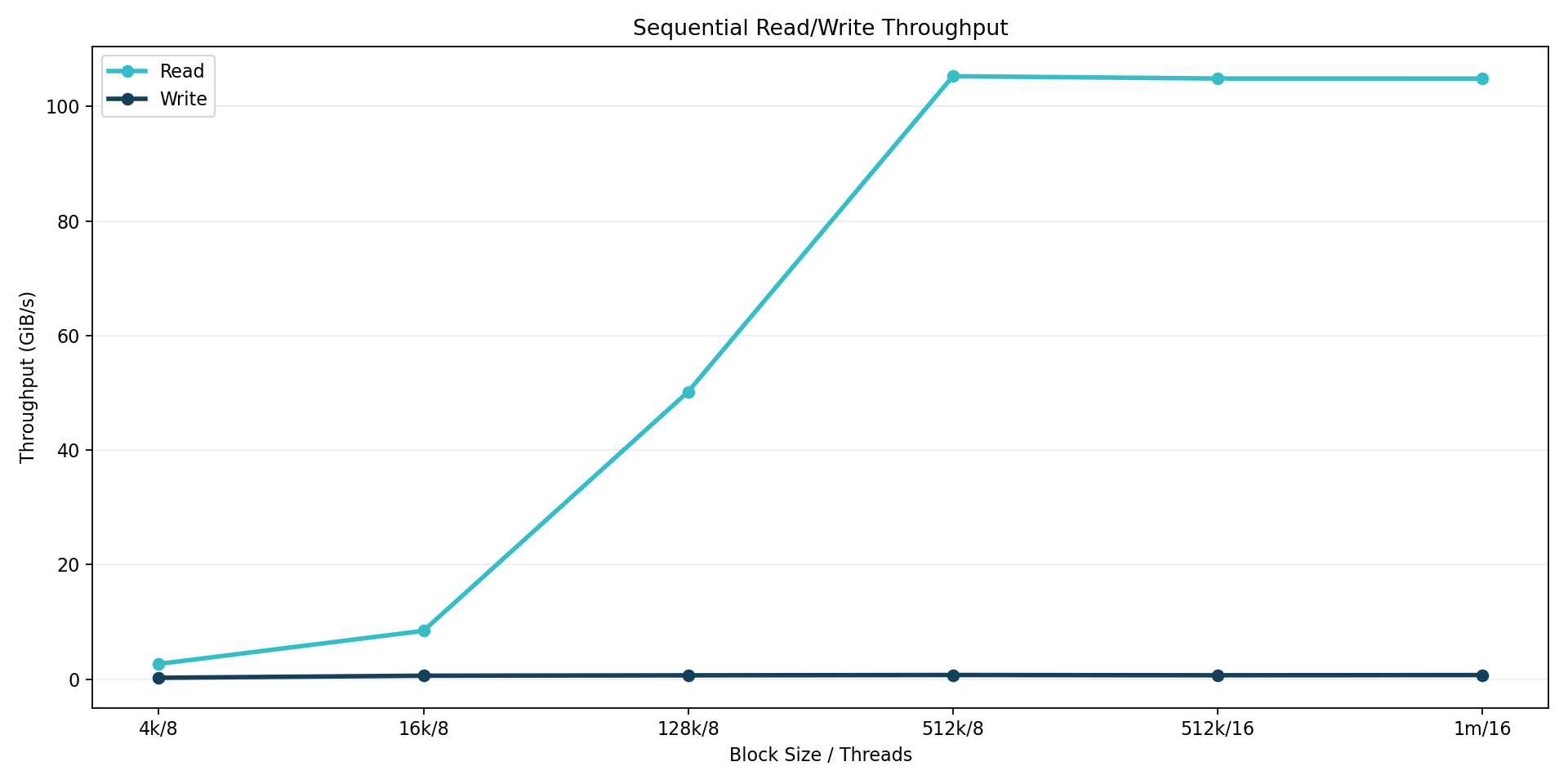

Okay, we’ll add BTRFS for extra integrity checking, right? Not so fast there – that will add significant overhead. Without extra tuning, this is what happens to the benchmarks:
And, the biggest of oofs:
With btrfs filesystem we’re at 40% of peak performance read and a tiny tiny fraciton write. (This is mkfs.btrfs “heres my storage volume please make a filesystem” defaults fwiw; tuning here is possible and recovering the write performance can be done however even with that tuning the overhead was still significant – greater than 50% reduction and increases in CPU overhead more than 2x what I’d expect in this kind of scenario).
(ps. the first write problem here is actually interesting.)

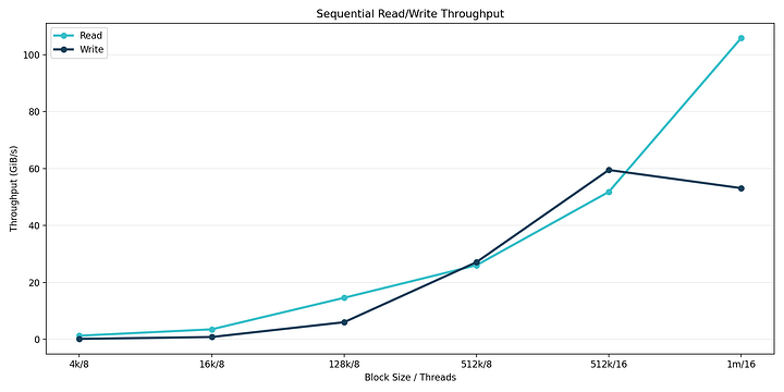

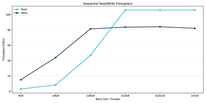

XFS Filesystem
XFS has metadata journaling. It also has much less overhead than BTRFS.
Still better – but the fs needs tuning to allow it to use more cpu overhead in order to achieve max throughput.

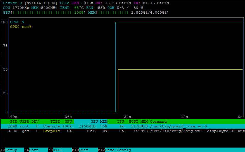

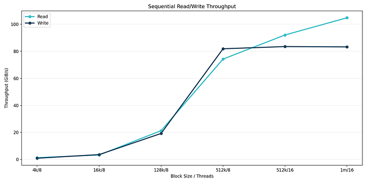

How Busy is the GPU, really?
The GPU is apparently in a tight loop, so 100% utilization all the time.
Part of this may be to make it harder to suss out that the GPU really isn’t doing all that much except 1) managing the vast swarm of DMA requests/traffic and 2) write parity calculations
It seems clear that, at least for my setup, there is an upper write limit of ~~80 gb/sec. That’s nothing to sneez at, to be sure, but I suspect on an A2000+ it would be better.

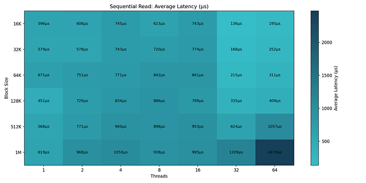

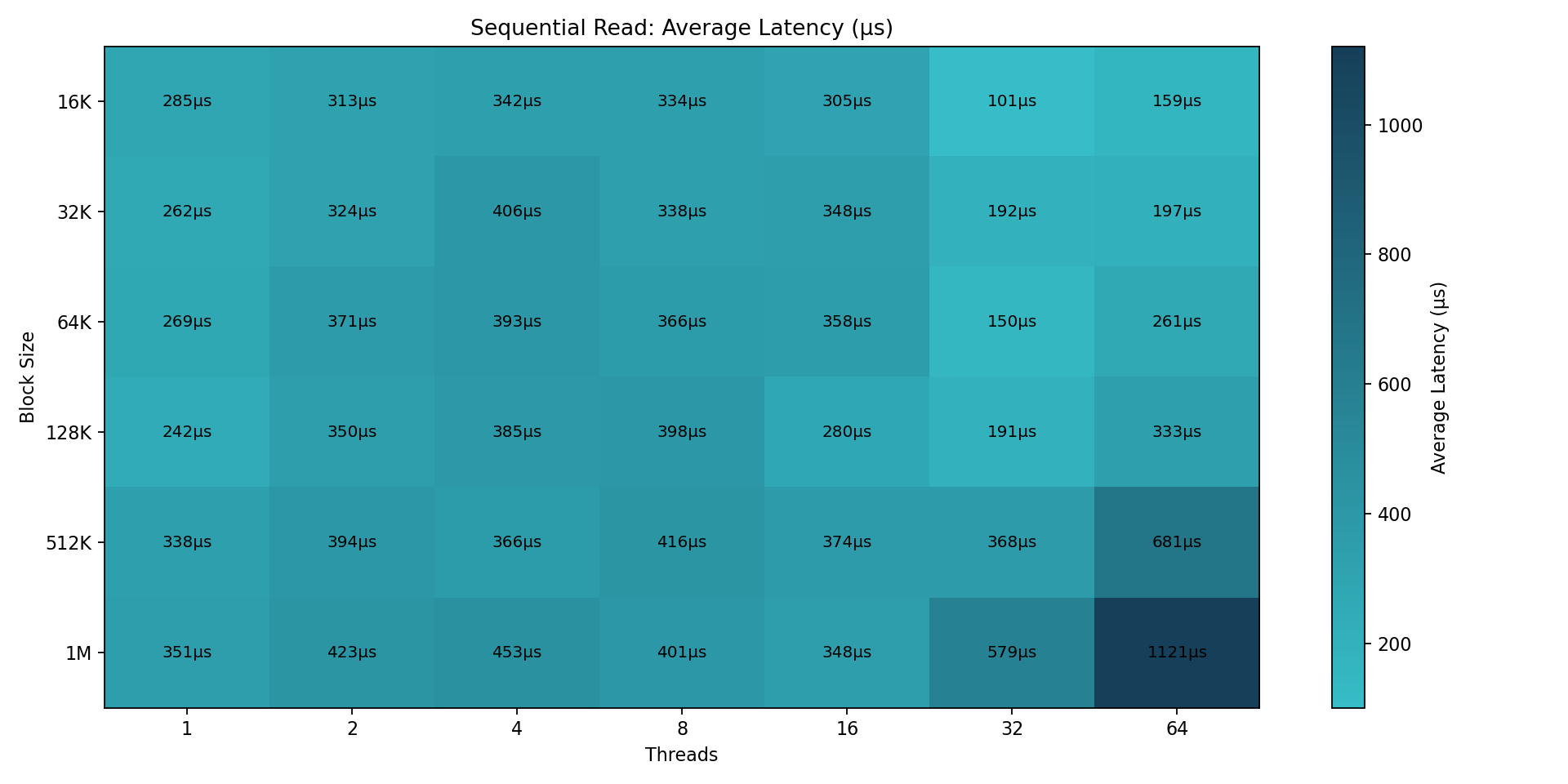

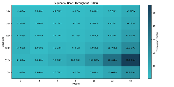

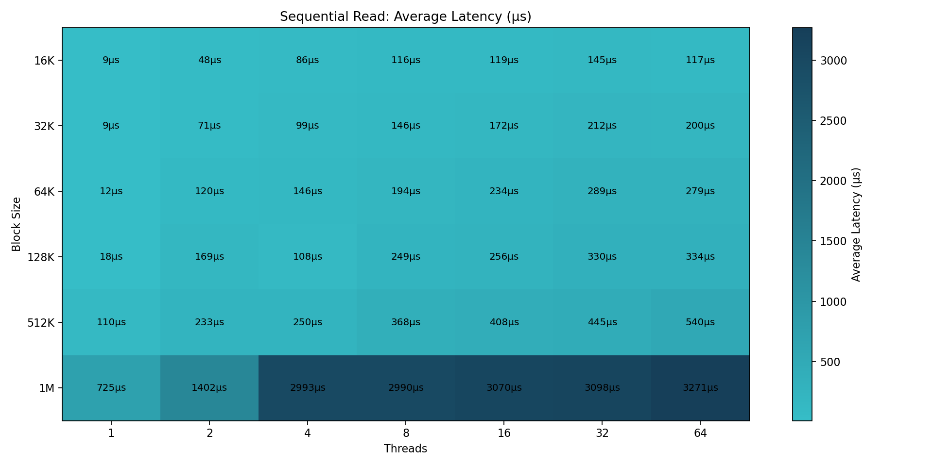

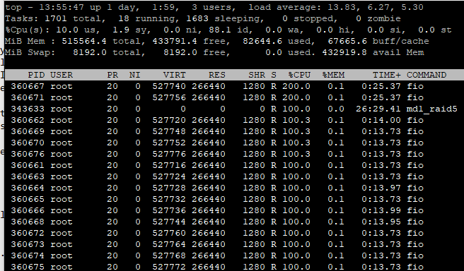

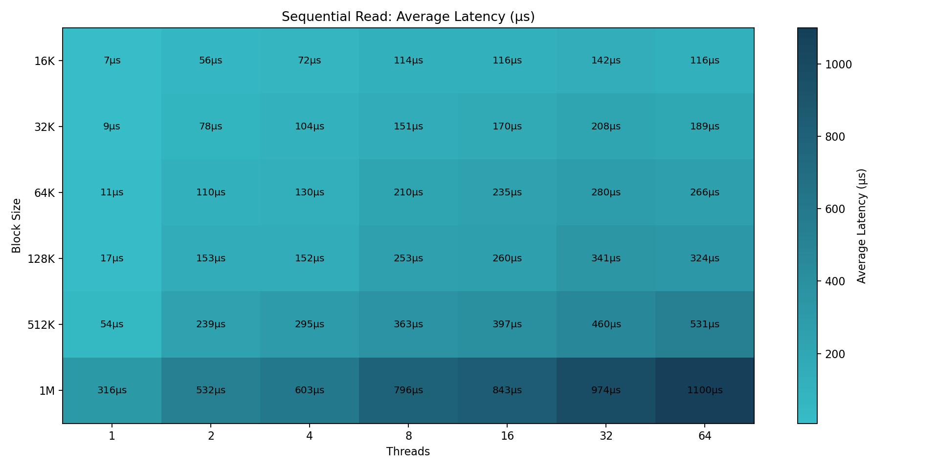

Okay, what about Linux MD?
more than 2 cores needed per i/o thread to saturate gen5. Ouch!

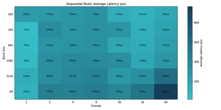

Raw block device; no filesystem overhead:
Note: This one is a bit misleading because it was really hard to eliminate the OS cache at smaller block sizes and thread counts because of the amount of ram in the system.
Very similar topline performance! But much higher cpu utilization.

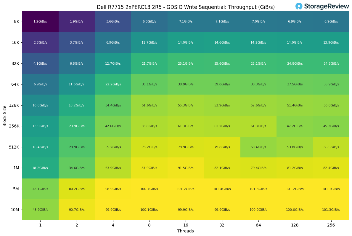

The newest PCIe 5.0 hardware raid controllers are comparing very favorably to the newest version of Graid’s SupremeRAID.
Storagereview’s done a sortof apples-to-apples comparison between “real” hardware raid and Graid using GDSIO and FIO and hardware raid is consistently ~2-10 times faster than the SupremeRAID.

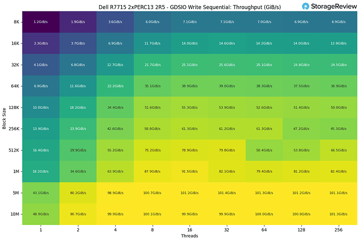

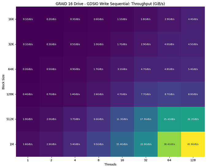

From Storage Review’s Graid testing:
versus Storage Review’s “real” hardware raid testing:
The two tests aren’t a perfect apples to apples comparison because the hardware raid has more SSDs (although something tells me the Graid solution wouldn’t scale well to more SSDs even if it had them) than the Graid array; although the hardware raid is still restricted to the same total number of PCIe lanes to SSDs as the Graid array, 64 total lanes.
It’s probably somewhat fair to half the hardware raid numbers compared to the Graid numbers, even still the hardware raid is performing much better at small block sizes and lower thread usage (and presumably lower queue depth too).
