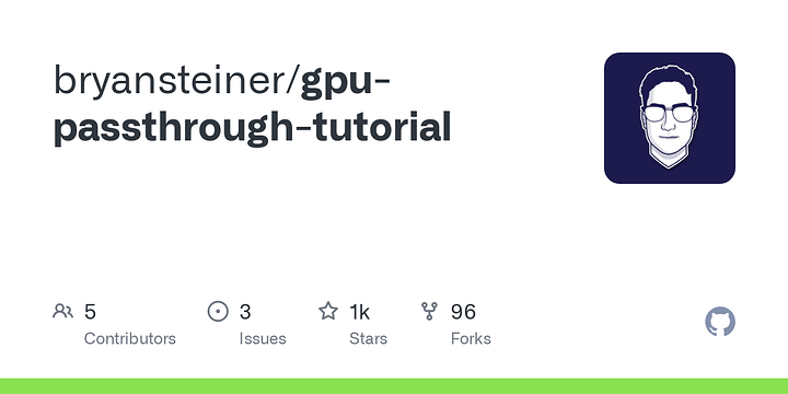

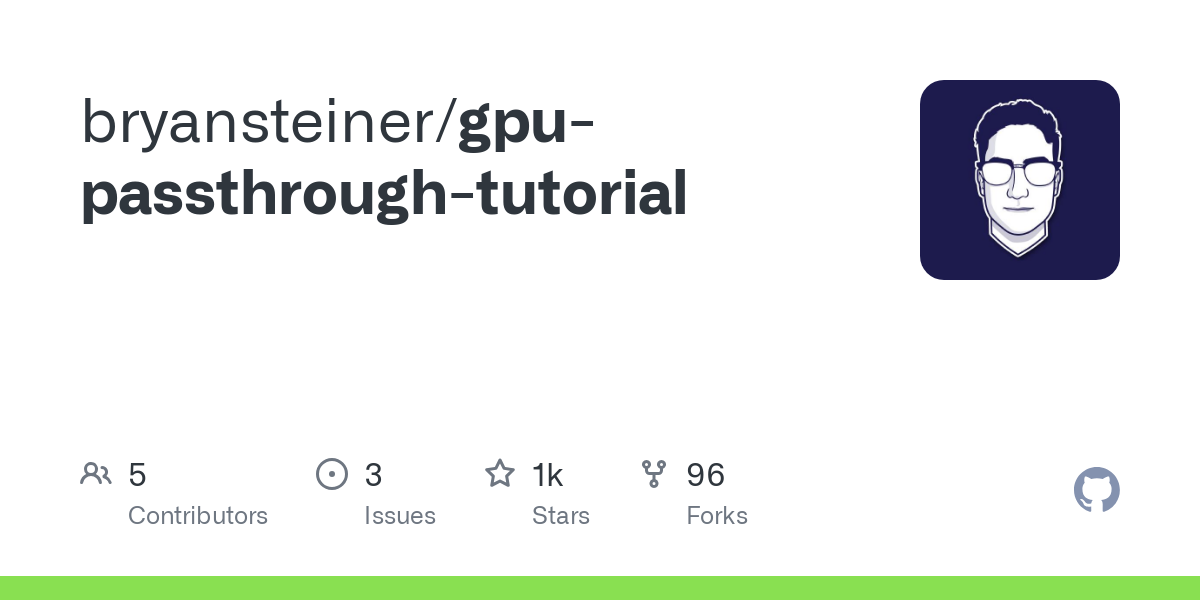

I mostly followed this tutorial:
With these two exceptions: I only passed through the GPU with video and audio device, no NVMe; And I didn’t apply any Error Code 43 mitigations, since my second card that I am passing through is an RTX 4000 Ada which shouldn’t need it.

even though the tutorial had instructions to remove and add the GPU through hooks on boot/ shutdown of the VM.

Yes, the GPU is still bound to the nvidia driver and when you try to start a VM it crashes because it can not attach the PCI device. That is definitely a problem. In this case of the tutorial you linked the person is using custom scripts to attach and detach the GPU on demand, but as it seems that is not working correctly. If you want to follow this setup I leave it upon you to debug these scripts.

Have you placed the scripts in the according directories that correspond to the name of your VM? Because the win10 folder in qemu.d is a placeholder that needs the name of your VM? Have you done that?
