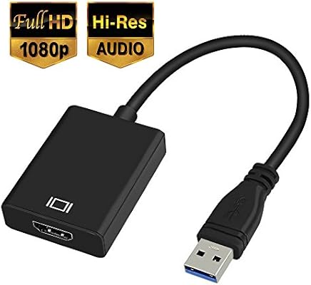

Cheapest would be a USB3->HDMI adapter. Note the 20% off coupon.
If you have a PCI slot, it’s worth spending twice as much on the cheapest real graphics card you can find, though. USB3 graphics can be a bit stuttery when your CPU is loaded.

Pretty safe to say you don’t have USB3 then. Just get a cheap AGP video card, there are tons on amazon. Just google to check that it works in your version of windows.
