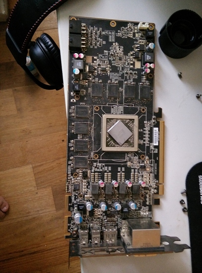

So I have recently made a blog post about my 6950 1GB XFX and have started cleaning it. The only problems is that I am having issues trying to get off the excess thermal paste around the gpu die and the vrms which is a total bitch to clean off. Any tips? I have tried using toothpicks and q tips and still not clean to my standards yet. Yes I was being careful with the toothpick to avoid any scratching, was just getting off the gunks of thermal paste stuck on the sides of the vrms.
I didn't have any rubbing/ Isopropyl alcohol but used methylated spirits instead which it worked fine.

Whenever I have cleaned thermal compound from gpus or cpus I always use paper towel first to remove anything loose, then apply isopropyl alcohol to a paper towel and clear the rest.
Isopropyl will evaporate quickly and leave the gpu clean.
This is the best that I did with what I had. So should I clean it more or start applying thermal paste and test it.?

its still bad, go back - clean up more. Get alcohol 90+...
yeah i'm going to go out anyways so might as well pick some up.
the more % the better. I also recommend getting ear cleaning sticks --> they are better for this kind of cleaning at this point.
It'll work fine like that, but it's best you clean a bit more. Wad up a coffee filter, douse it in alcohol and press it down on the caps. Basically just gently dab away at it for a bit and it should clean up a bit more. You won't get it perfect unless you want to trace each cap with the end of an exacto knife, peeling the tiny little bits of paste out from the corners.

Use an hair drier to dry the thermal compound all around the GPU and over it until it starts craking. Than use a plastic pryer to scratch everything off of it. If you use a softer plastic than the one used for the PCB you won't damage anything even if you apply a bit of force.

@Fouquin I have managed to fix the temps by applying a tad more thermal paste and re-applied the thermal paste to the die the third time (the die not the vrms.) it only managed to hit 84 while benchmarking which I am a very very happy person right now. It only hit to 84, sounds like a hairdryer but i am a very happy person.
I wouldn't suggest a oven at all if you use it to cook your meals in it. Heat all that amount of chemicals in a non ventilated space can lead to accumulation of the evaporation on the oven's sides and may be released over time when you use it. Maybe borrow a heat gun but don't overdo because if the temperature is too high some soldering may be come loose and the card would become a paper weight (oven is overkill too for this if you use a temp too high).

Soak it for a few hours / days. Soak a cloth in some alcohol and place it on the GPU and keep it in an air-tight box so it doesn't evaporate.
Too bad I can't really recommend you to use an ultrasonic cleaner, since you probably don't have one.
