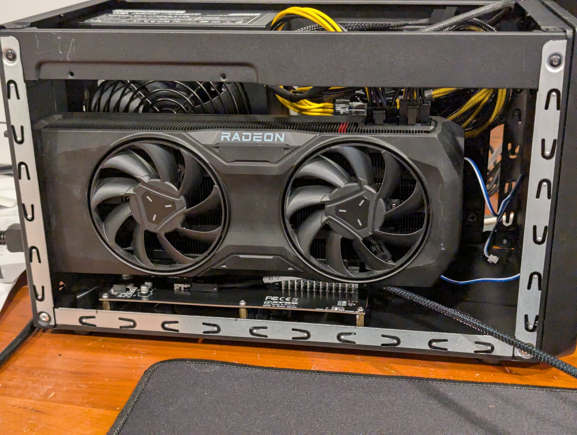

I’ve been working on a very similar project.
I retrofitted an old thunderbolt eGPU enclosure, drilled some holes and swapped out the thunderbolt board with a cablecc sff-8612 4x to pci-e host board. I also spliced in a variable voltage fan temperature speed governor to drive the case fan (since the oculink board, unlike the old thunderbolt board, doesn’t have any fan headers).
I popped in a 7800xt, and it works amazingly well with my mini pc (8845hs chip).
I ordered a gpd win max 2, and it just showed up. Right now, I’m a little disappointed that I’m not getting nearly the performance of the mini pc with the oculink gpu (tried on both Windows and Nobara Linux). Trying to troubleshoot, but kinda stumped. My only thought is that gpd programmed a very low tdp onto these machines. I’ve only had the laptop a little over a day, so maybe a few more days of searching will yield a solution.
Whats the difference? I was seeing like 15% loss
A little more significant for me. Using the same cable, host card, and gpu, I was able to get around 80fps on baldur’s gate 3 (4K, high settings) using the 8845 mini-pc over oculink, and more like 50fps with the win max 2.
A little hunting points me to the vram memory clock being very low. I think it’s a driver bug.
That said, I’m really happy with how it all ended up looking. It doesn’t look all janky like other oculink setups I’ve seen.
