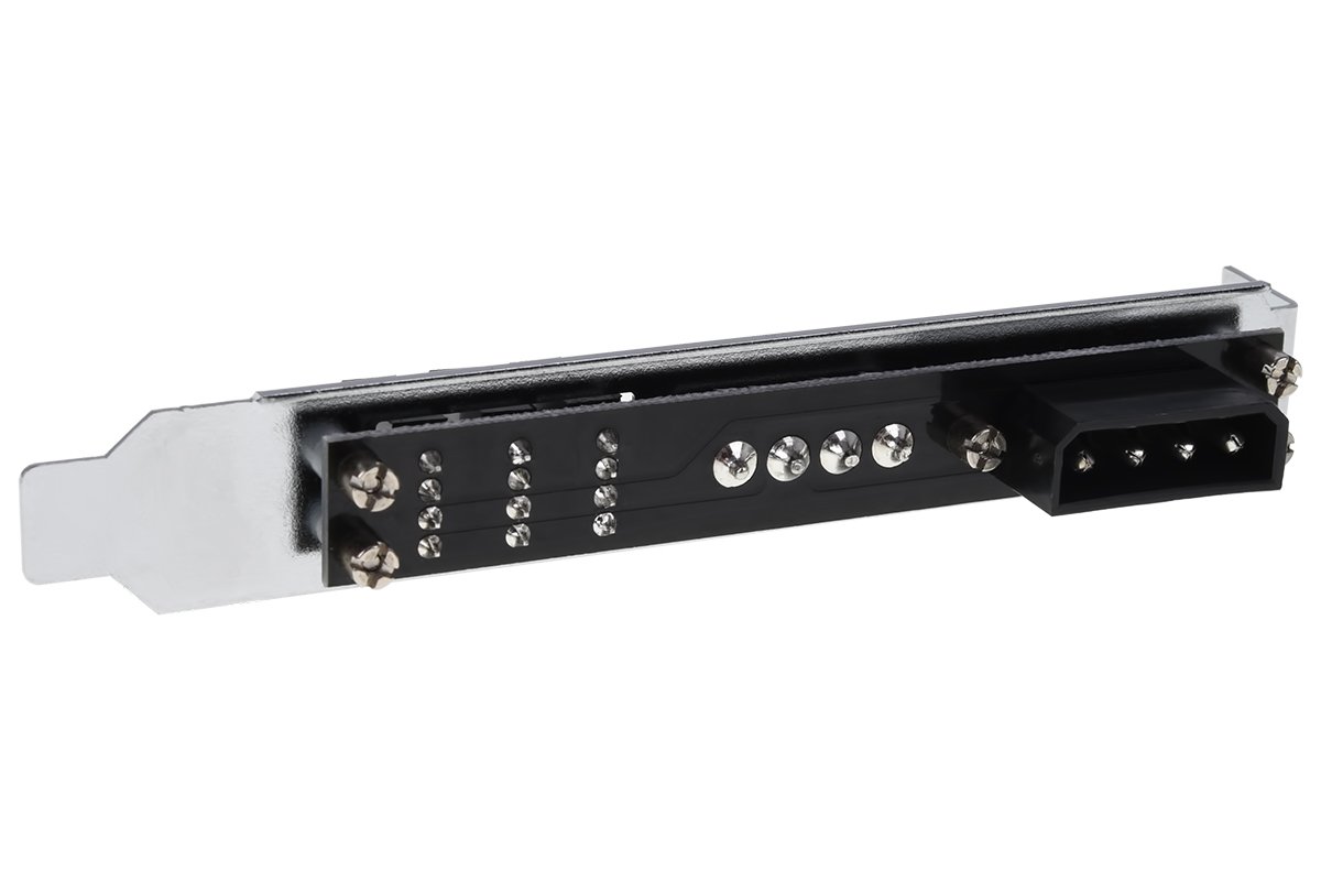

Any ideas? I was think of a PCI slot with Molex passthrough, but that seems hard to come by

I’d opt for a 4 pin *something panel mount connector on both ends. Wouldn’t be much more cost and it would almost look like you knew what you were doing.
How the heck did you find that!!! THATS WHAT I NEED
Usually someone somewhere had something similar in mind so it’s a matter of looking around.
It’s just google images + molex pci = and we are optically looking for what may best suit our needs.
