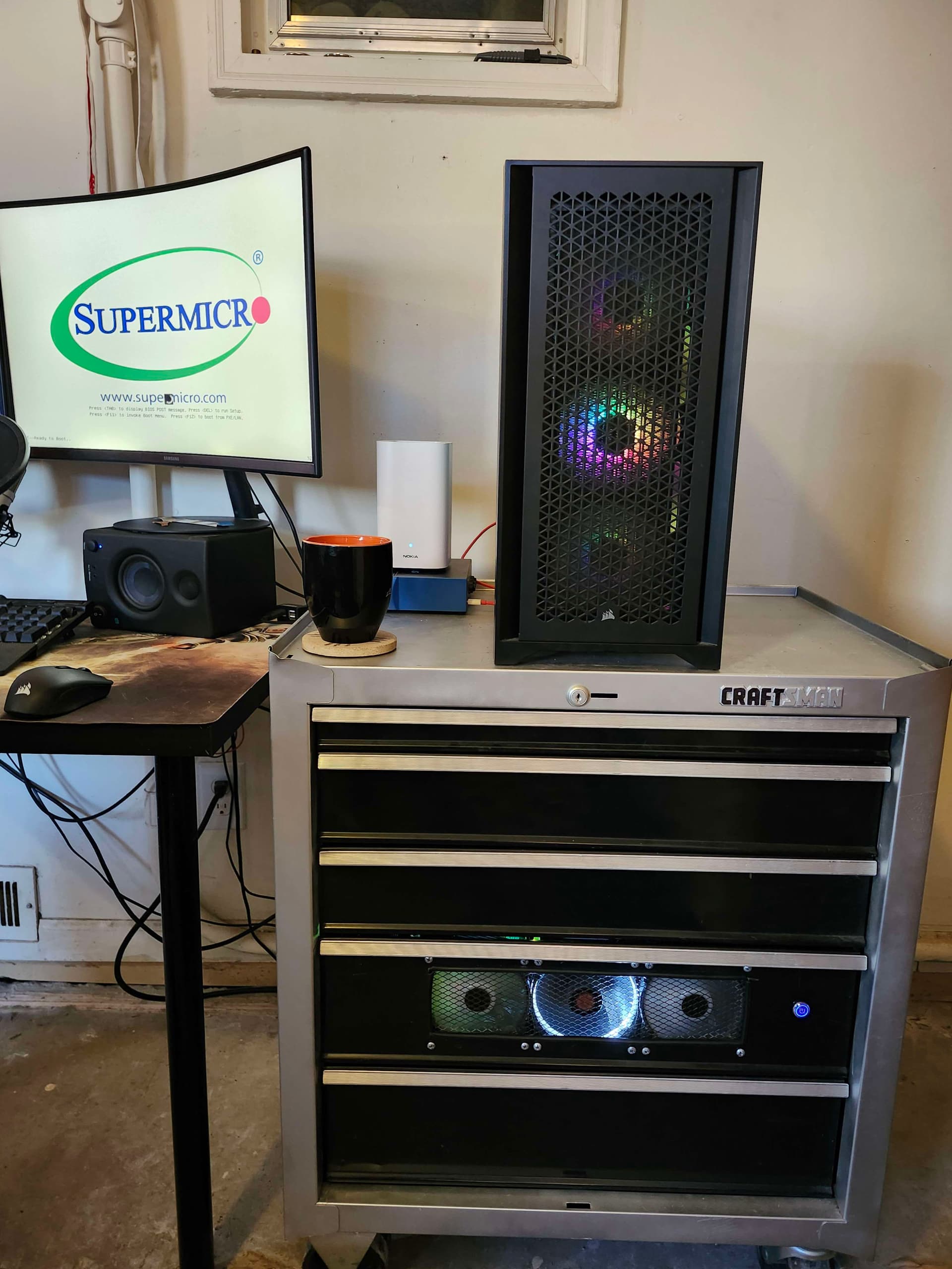

side note you are really making me want to put this with a rtx9000 in my toolbox.
