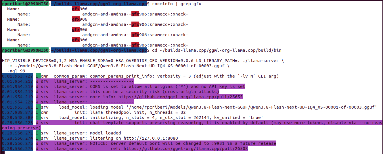

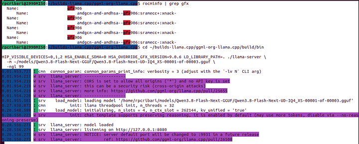

Does this work for you with Qwen3.8 Flash Next? I got it working with Qwen 3.6 35b a3b without issue. But i’m struggling with Qwen 3.8 Flash Next. (Got a nice speed boost on Qwen 3.6 35b from 50tps to 70-tps! thx!)
Sorry i have not tried it as my GPUs only have a total of 40gb of vram. What error do you encounter exactly?
rpcribari@2990MI50:~/builds-llama.cpp/milpster-gfx906-llama-cpp/build/bin$ ./llama-server -m ~/models/Qwen3.8-Flash-Next-GGUF/Qwen3.8-Flash-Next-UD-Q4_K_XL-00001-of-00004.gguf -t 16 -ngl 999 --split-mode layer -ctk q8_0 -ctv q8_0 -c 8192 --host 0.0.0.0 --port 8080
0.01.880.020 I cmn common_param: common_params_print_info: verbosity = 3 (adjust with the -lv N CLI arg)
0.01.880.518 W srv llama_server: -----------------
0.01.880.522 W srv llama_server: CORS is set to allow all origins (‘*’) and no API key is set
0.01.880.523 W srv llama_server: this can be a security risk (cross-origin attacks)
0.01.880.524 W srv llama_server: more info: server: add --cors-* options by ngxson · Pull Request #25655 · ggml-org/llama.cpp · GitHub
0.01.880.524 W srv llama_server: -----------------
0.01.881.885 I srv load_model: loading model ‘/home/rpcribari/models/Qwen3.8-Flash-Next-GGUF/Qwen3.8-Flash-Next-UD-Q4_K_XL-00001-of-00004.gguf’
0.28.959.850 I cmn init: llama threadpool init, n_threads = 16
/home/rpcribari/gfx906-llama-cpp/ggml/src/ggml-cuda/ggml-cuda.cu:108: ROCm error
0.28.977.966 E ROCm error: invalid device function
0.28.977.973 E current device: 0, in function ggml_cuda_kernel_launch at /home/rpcribari/gfx906-llama-cpp/ggml/src/ggml-cuda/common.cuh:1723
0.28.977.974 E hipGetLastError()

I’m getting a nice speed boost on Qwen 3.8 27b too. Went from 18tps using Vulkan to 30tps using ROCm.
Turns out the problem is my 4th MI50 is running the Apple Vega Pro II firmware. I needed it for displayport out. But it turns off ECC apparently and ROCm wasn’t happy with 3 using ECC and 1 not. I disabled it and the model loads without issue.

Did a git clone of your repo today finally and built it with the same build flags as mainline and it’s a tad slower than B11577
Is it how I’m building both?
I however got a nice speed bump from avoiding k quants right now, apparently our gcn cards do better with just f16,q8_0,q4_1 (q4_1/q4_0)
I’m now at 500t/s for pp16384 and 29t/s for mainline llama running qwen3.8-27B-q4_1
With q4_k_m it’s 263/25 with the 906 build and 412/26 with mainline build so the q4_1 quant was a nice bump over q4_k_m.
